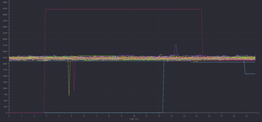

Case 1 : Facing the ceiling, steady
Observation : Takes some time for the outlier values to return to normal value

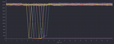

Case 2 : Waved my hand once above the TOF
Observation : Some outlier values appear (purple blue around 0mm) after my hand are no longer on the TOF

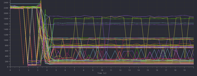

Case 4 : TOF facing the pillows, steady
Observation :

For Case 1 & 2, why do the outlier values take a long time to return to the normal reading position?
-> How do we have those outlier value returned to the normal position quick?
Our doubt is that, with case 3 & 4, since everything in the scenario is steady (not moving).
->Why is the output of the values fluctuating?
Our understanding to the sensor is that, if the TOF is facing/ sensing an area with non-moving/steady objects, it should return stable values, and values should not be fluctuating. Is it related to the settings in the fw?

Number 1 - go immediately to the VL53L8. Same price, Same FoV, better performance. (We improved the optical elements - but also changed a lot of other things as well.)
The fluctuations are due to the fact that under the covers we do 4, 4x4 sub ranges and stitch them together. And with fast movement the 4 sub-ranges don't line up.
Number 2 - Doing 2Hz continuous, means you are integrating for a full 1/2 second.
Don't do this.
Instead change the mode to Autonomous and integrate for something reasonable. 10ms is more than enough.
You might even like 5ms better. Try this even before going to the L8.
I recommend both of these, but just try #2 and see if it solves your issues.

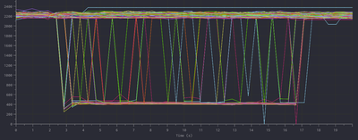

However I have changed the fw setting to what you recommended : Autonomous mode and 10Hz (I assume).
Read for 10 seconds, the sensor is placed steadily and is facing the ceiling, no moving objects is in the FOV.
-> Seems there are lots of fluctuations going on

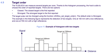

Other than that, regarding the target order, how does one choose the best ?
Since all the 8x8 values are retrieved from the [1,1] to [8,8] (assume the SPAD to be a 8x8 matrix), how does the target order affect these values?

There are 64 zones and in theory each zone can return 4 targets. But in practice two targets is kind of the practical limit.
If you look down on a bed, some zones will see the bed, some will see the floor. Some zones will see both the bed and the floor.
I generally sort by closest. In most cases closest is strongest as near targets return more photons than do far ones.
But say your floor were particularly reflective and the bedding was not. Possible to have the floor be stronger.
If you go through the structure (and you configure your platform.h to specify 2 targets) you will see them in each of the 64 zones.
