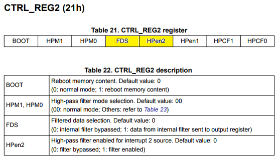

Posted on March 16, 2018 at 14:51
WHO_AM_I : Read only
CTRL_REG1 : 0x37
- normal mode.
- 400Hz.
- X, Y and Z axis enabled.
CTRL_REG2 : 0x14
- High-pass filter normal mode.
- data from internal filter sent to output register.
- High-pass filter enabled for interrupt 1 source.
CTRL_REG3 : 0x04
- Interrupt request latched on INT1_SRC register
CTRL_REG4 : 0x90
- 200g full scale selection
- output registers not updated between MSB and LSB reading
CTRL_REG5 : 0x00
- Sleep-to-wake function is disabled

Posted on March 19, 2018 at 15:59
OK, I see the problem.
In the configuration CTRL_REG2 : 0x18 you enabled the high pass filter for interrupt  2 source, but then you configured interrupt one (INT1_CFG : 0x2A, INT1_THS : 0x02). So the data without high pass filter are compered with the threshold in the interrupt 1.
You should set the CTRL_REG2 to 0x14.
Posted on March 19, 2018 at 16:06
Thank you for your response, but unfortunately I misread my own configuration.
I am actually configuring CTRL_REG2 with 0x14 instead of 0x18.
