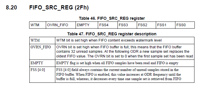

[lis3dx] What should the FSS[4:0] be valued when the fifo is full
  • March 20, 2018
  • 1468 views
Posted on March 20, 2018 at 07:43
FSS[4:0] contains the unread samples stored in the FIFO. So when the EMPTY is 1, the FSS[4:0] is 0. But when the OVRN_FIFO is 1, the FSS[4:0] should be 32 but it can't. So when
FSS[4:0] is 31 we should check the OVRN_FIFO flag to judge the real unread sample number. Is that correct?
Best answer by Winfred LU
Posted on March 20, 2018 at 09:39
Hi Kefei,
Correct. Reference the below table:
  • OVRN=0, FSS=11111  --> Unread FIFO samples = 31
  • OVRN=1, FSS=11111  -->
     Unread FIFO samples = 32
