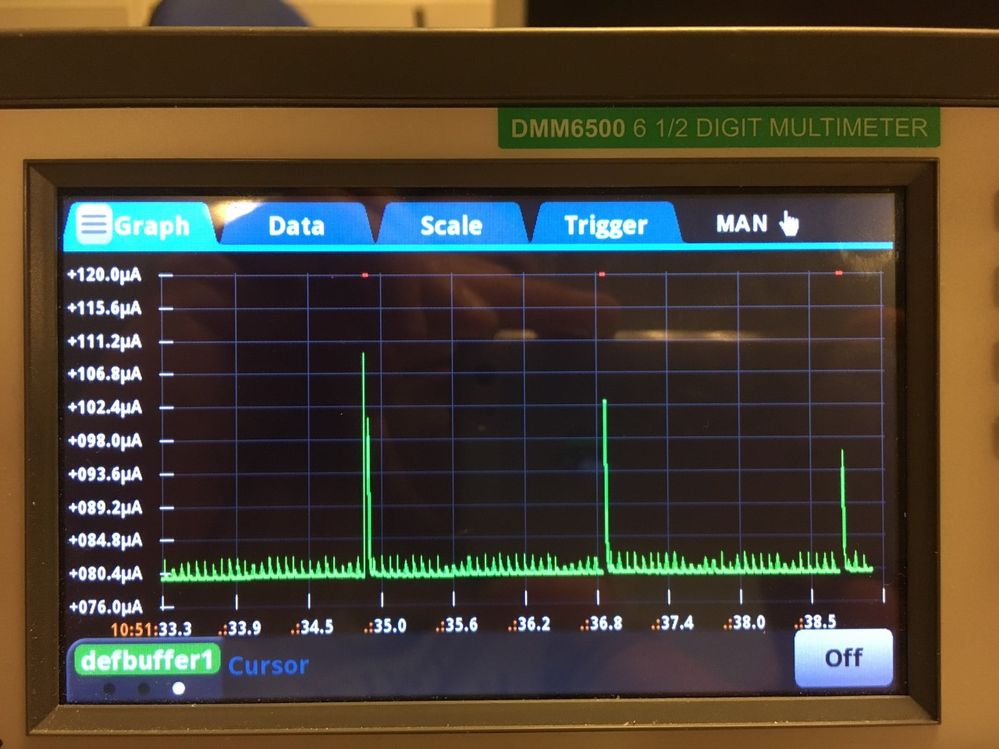

Is there any ressource describing the consumption during 10Hz Low-power mode ?
On my side I think I can see little peaks each 100ms then one litle larger peak each 2 seconds.
  • Is that the normal behavior ?
  • Is it possible to find a typical consumption curve of the sensor during LowPower mode ?
  • If the 2 second litle larger peak is a particular processing, could it imply a kind of latency before the awaking of the sensor (passing in normal mode, or generating IT), maybe due to the eventual High pass filter ?

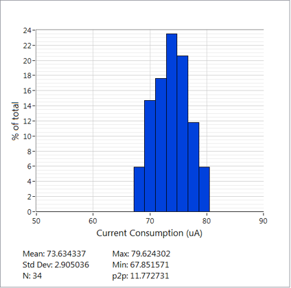

    Hi @PGoud​ ,
    I believe it is normal to experience higher current consumption during the operativity of the digital interfaces: for example, during SPI/I2C communication the Vdd / VddIO consumption will be higher (especially on VddIO for I2C) since the dataout is communing High-Low and the current consumption is higher during this phase.
    For the Current consumption values in LP mode, you can refer to the datasheet, p. 10. I can say you that that value of 10uA refer to ODR = 1Hz, while the average value at 10Hz is about 75uA.
    In particular, I can share with you some bench data on a representative production samples, but not the I supply vs time graph:
    About the little peak after 2s... do you have enabled some particular event recognition / interrupt triggering every 2 seconds? Otherwise there shouldn't be anomalous peak during (well, there is the possibility to set ODR 0.5Hz, the lowest ODR mode, but it is not your case I see... at least there should not be extra consumption due to the ODR clock tree...).

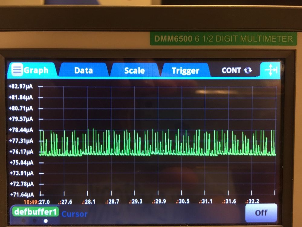

    PGoud
    PGoudAuthor
    February 18, 2021
    Still struggling with my 70 uA to high consumption.
    As an exemple here are my board consumption with H3LIS331DL in "Power down" mode and in "Low power mode 10Hz/100Hz".
    As I told you befaore you can sees the peaks of about 300uA/20ms each 2s. I suppose this could be the working consumtion in LowPower mode. Could you confirme me that .
    But My problem remain with the 70 uA FEET of consumtion, notice I could also measure abou70 uA directly on the VCC of H3LIS331DL in any of these modes ...
    I tried using INT1 in "open drain" with pull up on MCU side, and in PushPull without any pull on MCU side. In both cases I use "Active low" modes.
    Please any idea is welcome

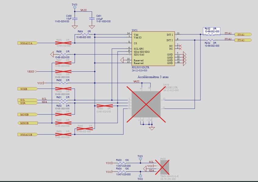

    PGoud
    PGoudAuthor
    February 19, 2021
    I'll make more tests this afternoon.
    However here is our schematic of Accelero's part.
    Eleon BORLINI
    February 19, 2021
    Schematic looks ok... Which is the Vdd/VddIO value?
    -Eleon
    PGoud
    PGoudAuthor
    February 19, 2021
    Hey !!
    I did not take care of this but I was SDO set to 0 to choose and adress different from LIS2DE seems to be my over consumption problem !
    Please could you confirm me that the electronic behind SDO could generate this consumption.
    That's really sad for us if this is the case and if the LIS2DE has got the same problem, because we planed to use both circuit simultaneously in some cases ...
