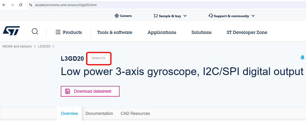

Andrew Neil
It seems the L3GD20  is obsolete:
But, on the 'Documentation' tab, you can still find the datasheet and some Application Notes:
https://www.st.com/en/mems-and-sensors/l3gd20.html#documentation
It seems there is still support in the C-Driver-MEMS package:
https://www.st.com/en/embedded-software/c-driver-mems.html
https://github.com/STMicroelectronics/STMems_Standard_C_drivers/tree/master/l3gd20h_STdC
