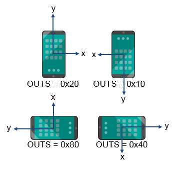

Hi ST, I'm working with LSM6DSO on gesture recognition​. It would be great if you could share fsm examples especially for 4D app. Thank you! John

Hi John, yes of course, you can check a dedicated post here:
https://community.st.com/s/question/0D50X0000AIaV7WSQV/fsm7-how-to-test-your-fsm-4d-orientation-an-algorithm-example
I attach you the example to be uploaded in Unico, referring to the configuration below
Please note that the same FSM code can be used also for LSM6DSOX
Regards
