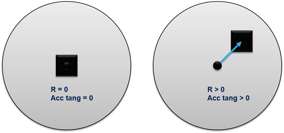

Consider that the interrupt generation depends on the reciprocal position between the sensor/board and the lid. The accelerometer detects the linear acceleration, so the module depends on the distance of the sensor from the center of the lid.
When you are configuring the INT1_CFG  register, you could select the AOI bit to have an interrupt only when both axis exceed the threshold, and you could also try to tune the INT1_THS - 0x10 in a different value than 250mg.
