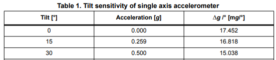

the AN4509 reports some of the thresholds related to the tilt degrees. Suppose you have your device with the z axis measuring 1g (flat position), the x and y axis will measure 0 LSB = 0 mg. If you set the threshold at 15° and enable X_WU and Y_WU (not the Z_WU), because the Z_WU would always generate an input when in flat position (Z = 1 g).
0693W000004Jcc7QAC.pngFor the threshold calculation, please consider what reported in the datasheet p.48: Wakeup threshold, 6-bit unsigned 1 LSB = 1/64 of FS. Default value: 000000.

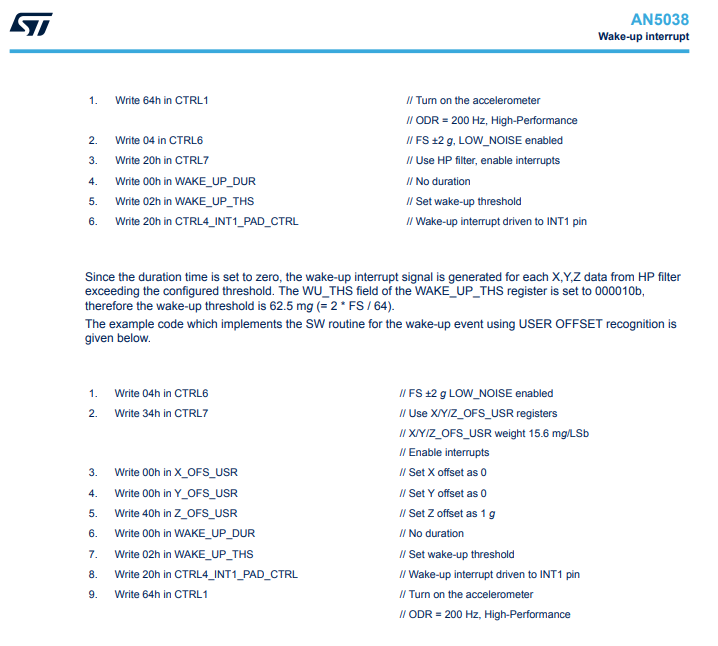

For setting wakeup for tilt angles is not worked , I referred
https://www.st.com/resource/en/application_note/dm00401877-lis2dw12-alwayson-3d-accelerometer-stmicroelectronics.pdf. page no.22.
But What I have seen is the interrupt is generated for TAP events not tilt. The code I pasted below
dev_ctx.write_reg = platform_write;
dev_ctx.read_reg = platform_read;
dev_ctx.handle = &hi2c1;
lis2dw12_device_id_get(&dev_ctx, &whoamI);
if (whoamI != LIS2DW12_ID)
 return error;
lis2dw12_reset_set(&dev_ctx, PROPERTY_ENABLE);
do {
lis2dw12_reset_get(&dev_ctx, &rst);
} while (rst);
lis2dw12_full_scale_set(&dev_ctx, LIS2DW12_2g);
lis2dw12_filter_path_set(&dev_ctx, LIS2DW12_USER_OFFSET_ON_OUT);
lis2dw12_power_mode_set(&dev_ctx, LIS2DW12_CONT_LOW_PWR_LOW_NOISE_12bit);
lis2dw12_wkup_dur_set(&dev_ctx, 0);
lis2dw12_offset_weight_set(&dev_ctx,1);
lis2dw12_wkup_threshold_set(&dev_ctx,2);
lis2dw12_usr_offset_x_set(&dev_ctx,0);
lis2dw12_usr_offset_y_set(&dev_ctx,0);
lis2dw12_usr_offset_z_set(&dev_ctx,1);
lis2dw12_pin_int1_route_get(&dev_ctx, &int_route.ctrl4_int1_pad_ctrl);
int_route.ctrl4_int1_pad_ctrl.int1_wu = PROPERTY_ENABLE;
lis2dw12_pin_int1_route_set(&dev_ctx, &int_route.ctrl4_int1_pad_ctrl);
lis2dw12_data_rate_set(&dev_ctx, LIS2DW12_XL_ODR_200Hz);
Note: I tried adding wakeup feed data set "lis2dw12_wkup_feed_data_set(&dev_ctx, 1)", but then TAP interrupt also stopped.
Is it possible to enable/disable an axis from interrupt for wake up?. I have seen options enable/disable axis for tap interrupt only. Rather I think we might need to set offset only for the required axes, please correct me.
