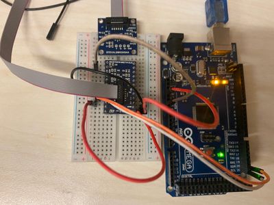

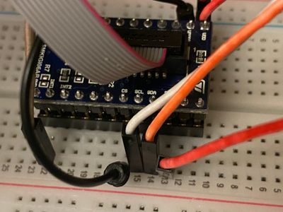

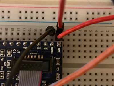

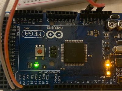

I recently bought the STEVAL-MKI245KA, consisting of an ad hoc PCB mounting the ISM330BX 6-axis IMU, which is connected through flat cable to a generic adapter board (STEVAL-MKIGI06A). I am trying to enable I2C commincation between the adapter board and an Arduino Mega, however, even after I connect the pins according to the datasheet of the components, when I run an I2C scanner on the Arduino, there are no devices detected. Here are my pin connections:
Adapter Board
Arduino
1
VDD
3.3V
2
GND
GND
3
SCLSCL
4
SDA
SDA
5
CS - VDDIO
6
SDO3.3V
The adapter board is mounted on a DIL 24 pin socket, which is then placed on a breadboard.
What am I doing wrong? I want to read and use the IMU readings, any suggestions on how I can do this any other way?

Recheck your assumptions, it should work.
Are there external pullups on the I2C lines? Can you look at the waveform? Perhaps show a picture of the setup. Is the chip powered appropriately? Can the Arduino detect a different I2C device?
August 7, 2024
There are no external pullups. do i need to add any?
The Arduino can detect other I2C devices, just not this one. I've added pictures of my set-up below, the code i used was just the Arduino Playground code for an I2C scanner (https://playground.arduino.cc/Main/I2cScanner/)
August 7, 2024
I2C needs external resistors somewhere. If it's working with other devices, perhaps those devices have pullups, but yes they need to be present somewhere.
It's possible they're on the adapter board. I didn't look for a schematic.
August 9, 2024
The I2C is working now, the scanner is able to find the IMU device at address 0x6B as it should. I changed my breadboard and it started working, so I guess the connections were bad the first time.

AtMega is 5V device, likely you need "logic level converter"
Tesla DeLorean
Guru
August 9, 2024
My thought too. With the wealth of 3V3 Arduino boards available in that universe, why use an ATMEGA at 5V ?
VDDIO on the MEGA's hard wired to 5V, and SDA/SCL will be pulled to that too.
