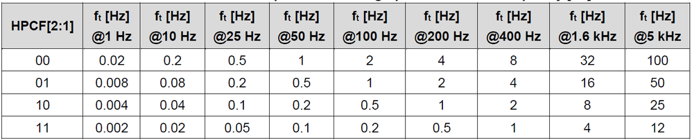

I am trying to develop a driver for my project which uses this Accelerometer / e-compass and while there is plenty of information for me to get something working, it is missing some information and some information is just not correct.
I would specifically like to add support for high pass filtering but I have no idea what HPCF[2:1] does - there was mention by someone at Pololu that the LSM303DLM datasheet has this information but can I fully trust that these filter coefficients are the same?

1. No there is no errata to the datasheet.
2. I would not recommend you to use other datasheet, even it the devices looks similar there could be differences.
Concerning the high pass filter cut-off frequencies (HPCF[2:1] bits) I can try to get the values.
The DRDY pin is data ready signal from the magnetometer only.
The INT1 and INT2 pins can be configures using CTRL_REG3_A (22h) and CTRL_REG6_A (25h) registers.
Where you can select which signals will be available on the pins (Data ready from accelerometer, threshold interrupt, FIFO watermark, ...)

Posted on February 23, 2018 at 13:02
Here are the cut-off frequencies for high pass filter:

Posted on February 24, 2018 at 23:11
Thanks for taking the time for finding this information Miroslav
Much appreciated
