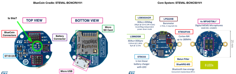

I have recently bought the BlueCoin kit. I have tried some of the demo project from the software library STSW-BCNKT01_V2.3.0, by directly dragging the .bin file into the Nucleo 64 board icon.
I'm experiencing issues with SD card demos, where the CoreSystem after programming needs to be connected to the Cradle board.
In these demos, as an example the SD_Audio, the function DATALOG_SD_Log_Enable() returns always 0, getting the application stuck in the else statement:
Why is this happening? The SD card is mounted, but the f_open or the f_write fails...
I have tried with a 32GB microSD card Fatfs formatted. It is an hardware fault or the is a bug in the ST demo?
Thanks in advance

Therefore should I buy and solder the one FTSH-105-03-L-DV connector (not provided) and one cable to connect the board to the ST-link on the nucleo?
If yes, can you provide the part number of the FTSH-105-03-L-DV female connector in order to make a cable out of it and reach the nucleo? I'm not able to find a 4 pins samtec connector.
In the picture the connector position is highlighted in green.
0693W0000058vwSQAQ.pngThanks
Hi @frnt​ ,
yes, it is the green circled area. I would have directly wired the exposed pads on the cradle, directly soldering 4 wires on them... I how this is a "patch" solution, but you always can use short wires and then plug extensions on them.
But ok, the female cable for the FTSH connector could be a standard ribbon cable. Please be sure that it is not too high and fits the available space.

Dear @Eleon BORLINI​ ,
I had to send the board back to seller because it was broken.
