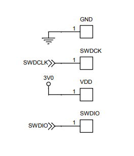

Hi @frnt​ ,
I checked internally and it is possible to debug the cradle + the bluecoin module (i.e. STEVAL-BCNCS01V1 + STEVAL-BCNCR01V1).
On the cradle module (STEVAL-BCNCR01V1) you have to physically wire the SWD pins shown below, that you can also find on p.3 of the schematic:
-Eleon
