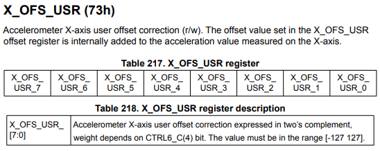

Then if I switch the chip's orientation from horizontal to vertical, I should get the exact same readings with just the values appearing at different axis letters?
This means that the chip internal circuits are symmetrical and calibration in one direction would not need to be redone in another direction/
Thanks
Eleon BORLINI
July 14, 2020
Yes exactly, flipping the chip you should get the same value changed by sign. This in theory, on the unsoldered sample, because the production calibration is performed to minimize the offset. However, you could encounter a residual offset that may be caused by the soldering process or a planar misalignment at application level. In this case, you can record the (average) offset value and store it changed by sign in dedicated registers (X_OFS_USR (73h), X_OFS_USR (74h), X_OFS_USR (75h), see the datasheet, p.95). Regards
