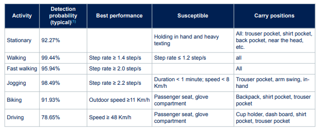

Eleon BORLINI
Here below a table describing the algorithm performances:
