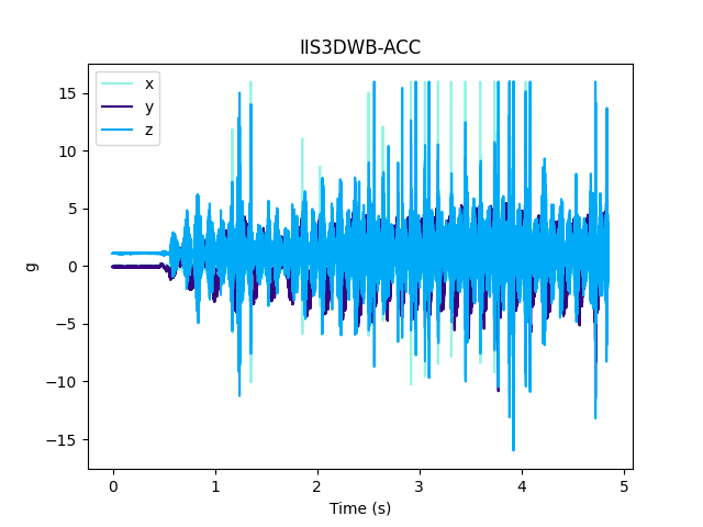

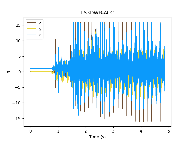

I compared IIS3dwb output with LIS3DSH output placing same place same orientation , when shaking at 500 hz lis3dsh showing y axis is having high g and its correct as shaker is shaking in Y axis. However IIS3dwb showing Z axis is sensing higher g values than y axis. Which is surely not true. To crosscheck I changed axis orientation against vibration orientation, but still z axis is sensing high g
0693W00000Bd1TuQAJ.jpg0693W00000Bd1UJQAZ.jpg0693W00000Bd1UsQAJ.jpg0693W00000Bd1VWQAZ.jpgIn fft view also all axis showing correct frequency but z axis is showing much higher amplitude
0693W00000Bd1WAQAZ.jpg0693W00000Bd1WeQAJ.jpgNow I am clueless what is wrong, is both IC faulty? or something wrong in settings
Thanks for reading any help appreciated.

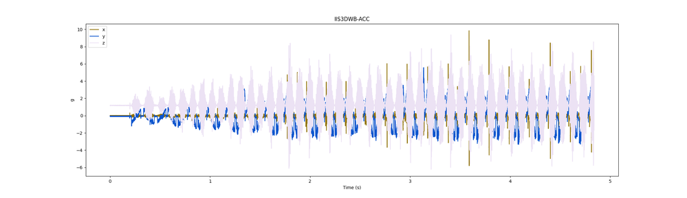

i have set the acquisition in FIFO mode
iis3dwb_fifo_mode_set(&iis3dwb_ctx_instance, IIS3DWB_FIFO_MODE);
with the following plot
0693W00000GVvFiQAL.pngthen i set the mode in Stream
iis3dwb_fifo_mode_set(&iis3dwb_ctx_instance, IIS3DWB_STREAM_MODE);
As you can see i still get high amplitude in Z although the movement is performed by hand along y-axis
waiting for your comments/thoughts
Thank you
Hi @trinitry​ ,
thank you for the details.
Maybe there is something wrong in cross axis of that batch of samples.
Or otherwise samples could have been damaged during the soldering process.
Did you also have the possibility to test the product on the STEVAL-MKI208V1K adapter?
-Eleon
Hello @Eleon BORLINI​ ,
I repeat the experiment with a new board (we are using the STWINKT1B) -
and the results moving the board along Y-axis (by hand) shown bellow
As you see the Z-axis (using a new board) has the same behaviour - it was noticed in other boards too.

Hi @SMaju.1​ , @trinitry​ ,
I understand your point.
From my visibility, we had no issues during the characterization of this device.
I have however directly involved the developers and the validation people now, and here below you can find their comments:
About the spikes at 16g, we think they are due to issues related to reading issue especially coming from the asynchronous communication at 12kHz. But the main issue for us is related to the mechanical fixing of the board: if you "glue" it to the edge in that way probably the board flaps heavily (and it's not even a small board).
You might try to repeat the test with vibration along Y axis but this time fixing the board in a flat position on the top of the shaker, and not cantilever-like.
As side note, we checked the post-solder offset and it actually tends to concentrate around 100mg, so the offset along Z is real. This can be however cancelled by configuring the USR offset registers.
By the way, is the board you used for the LIS3DSH as big as the IIS3DWB one?
-Eleon
