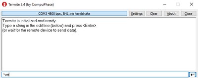

Can you download Termite and then check the version fw of your STEVAL-MKI109V3 writing *ver?
You should see 9.16. Let me know!

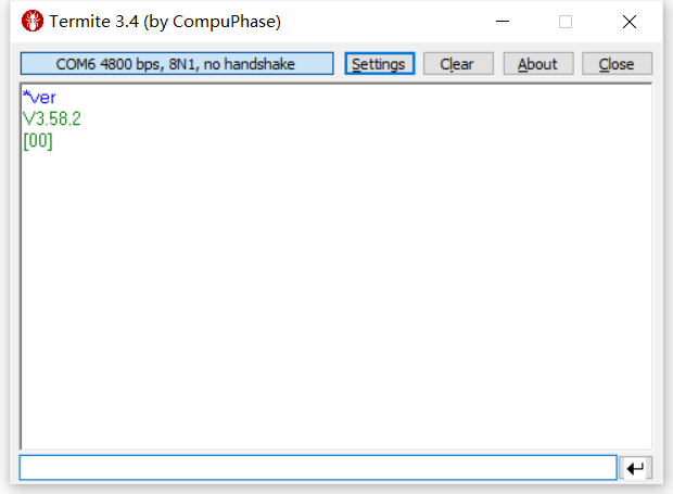

Hi @Federica Bossi , thanks a lot for your reply.
After connecting to the correct serial port (COM6) and typing "*ver", it shows v3.58.2. I guess this matches the firmware I chose "ProfiMEMSToolV3.58.2_00_08000000.bin" (part of Unico installation files) when using STM32CubeProgrammer? I am a bit confused why this should be 9.16...
