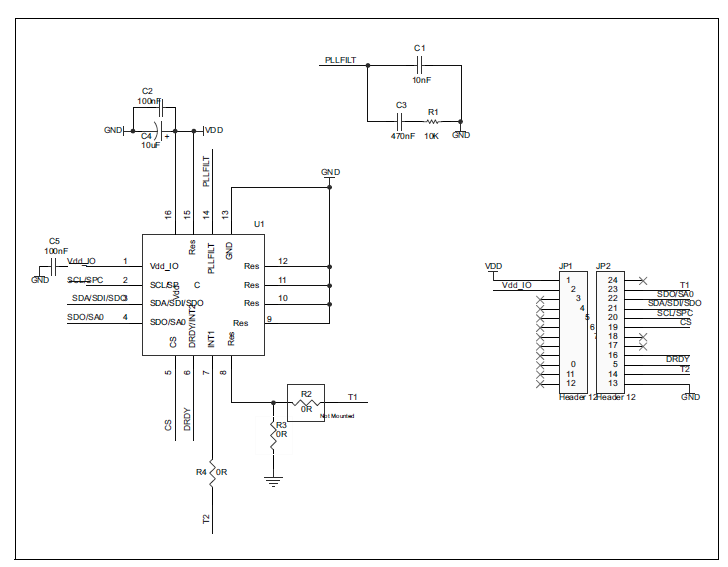

gist
Posted on January 27, 2015 at 16:41
Our problem was that the phase locked loop circuit on pin PLLFILT. We had a short between two points so that it didn't work. This caused the issues with only able to read 1 sensor value, then they stayed the same.

Posted on June 18, 2018 at 12:12
zuoshengting
‌ what exactly is your problem? Can you share your schematic?

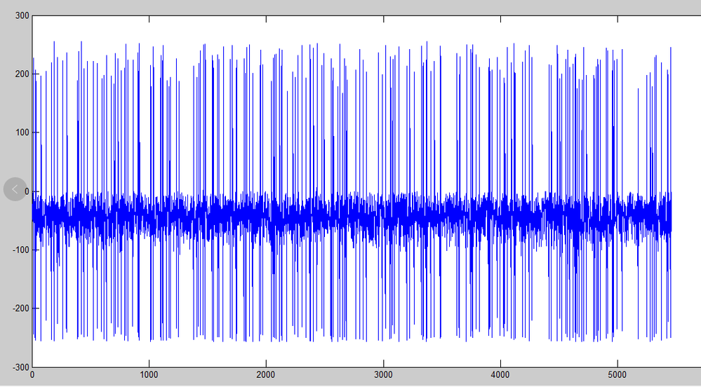

Posted on June 29, 2018 at 03:25
thank you for your reply.
I bought the steval-MKI125V1, and the schematic is here:
Now, I am able to read the angular rate of X,Y,Z, but there is a lot of noise. Here is Z axis data:
I really confused. Do I use the wrong way of getting those data? Or these noise is exist truly?
