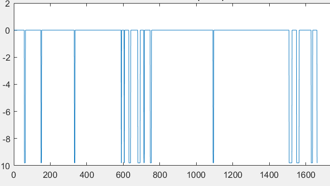

1. Does the MotionDI library output the gravitational acceleration along with linear acceleration as I am getting it in the lin acc. data? 2. How to wipe out the effect of gravitational acceleration in linear acceleration? Sensortile kit is used.
MAhm.1
Sensortile kit is used and linear acceleration is fused output from gyroscope and accelerometer,the sensor is kept with z-axis of accelerometer being parallel to gravity (screenshot attached).
1 REPLY 1
Petr S
Hi @MAhm.1​,
As far as I know the linear acceleration output from MotionDI should be without gravitational acceleration. Could you please send me your datalog that would include timestamp, acc & gyr & mag data and your calculated results? Attached is the example of the datalog format that would help a lot.
