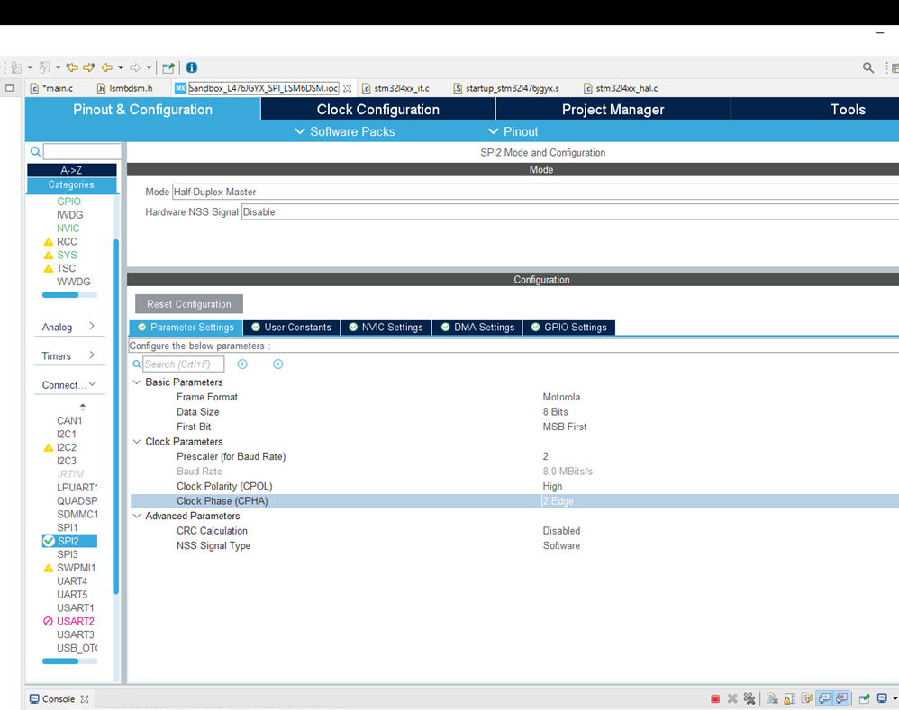

I would like to know what I am doing wrong or what register setting on the LSM6DSM that I missed setting?
Using a sensorTile (STM32L476JG) that is connected to LSM6DSM. APB1 Clk = 16MHz.
My settings are :
My code is trying to read WHO_AM_I register on the part, I get 0xC5 , should get 0x6A.
	  HAL_GPIO_WritePin(SPI_CS_GPIO_Port, SPI_CS_Pin, GPIO_PIN_RESET);
	  txBuf[0] = 0x12;
	  txBuf[1] = 0x08;
	  HAL_SPI_Transmit(&hspi2, txBuf, 2, 50);
	  HAL_GPIO_WritePin(SPI_CS_GPIO_Port, SPI_CS_Pin, GPIO_PIN_SET);

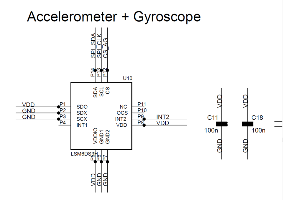

but are you using the 3-wire SPI instead of the 4-wire standard? IN the first case you have to properly manage the SDI/O line, and also to write the SIM bit of the CTRL3_C (12h) register (but, if the SPI is not working, this action would not be possible).

Yes I am using 3 wire SPI...I am using STEVAL-STLKT01V1....User manual clearly shows only 3 wire connection.....In CubeMX I am set up as Master Half Duplex...I believe this is all l have to do for 3 wire, correct? The board is a dev board and should be configured already.
Here is the sensorTile connection.....The pic suggests by the net name that it can be SPI but the data sheet calls the pin SDA, which is traditionally used for I2C??
Unfortunately I NEED PB14 and PB15 to work on the STM32L476JGYX part of the sensorTile. I have used up all the I/O which includes the coveted PC0 and PC1 for other external things. Please tell me it is possible to use PB14 and PB15 as SPI along with the below pic of the Accel wiring to it. PB15 cannot be configured as I2C.
Hi @SWenn.1​ ,
it's correctly a 3-wire SPI.

Please forgive me as I am a hardware guy at this end that is working my way through firmware....I was able to download the above as you suggested and include the folder /Components/lsm6dsm into my project. I can now see the function calls....Unfortunately I am struggling quite a bit trying to define the structure handle LSM6DSM_Object_t. All the pointers to functions, etc has me quite confused. I am using a sensorTile and am confident that the HW works.....I believe it is a matter of just setting up all the registers correctly on the SPI within the STM32L476 as well as the registers on the LSM6D. If you could supply me the LSMD6 registers and their settings (keep it simple just Hex values) that I need to set prior to reading the WHO_AM_I for 3-Wire SPI that would be helpful. I ordered a demo board with another variant of the LSM6D that is broke out with 0.100" spaced header on the board so that I can hook a logic analyzer up to it to see what is going on. I am pretty sure I have the Firmware on the STM32 correct as it is pretty simple. I am using 8MHz clock for the LSM6D, CPOL = 1 and CPHA = 2 Edge and have the STM3 as Master Half Duplex.
