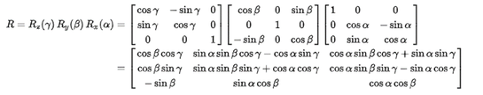

Rotation matrices can be obtained from these three examples using matrix multiplication. For example, the product:
Represents a rotation whose yaw, pitch, and roll angles are α, β and γ, respectively. More formally, it is an intrinsic rotation whose Tait–Bryan angles are α, β, γ, about axes z, y, x, respectively. Similarly, the product:

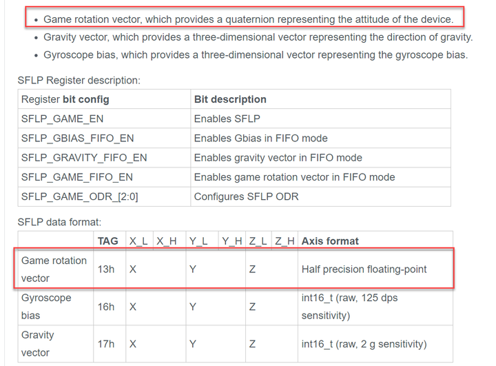

A sensor fusion low-power (SFLP) block is available in the LSM6DSV16X for generating the following data based on the accelerometer and gyroscope data processing:
- Game rotation vector, which provides a quaternion representing the attitude of the device.
- Gravity vector, which provides a three-dimensional vector representing the direction of gravity.
- Gyroscope bias, which provides a three-dimensional vector representing the gyroscope bias.

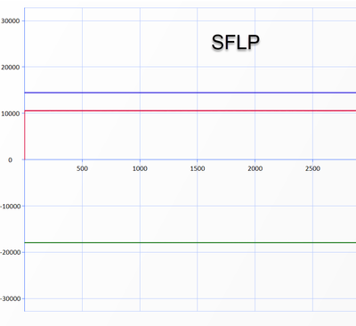

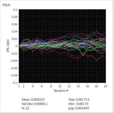

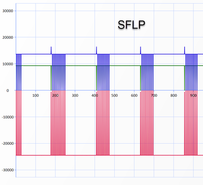

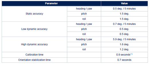

Sensor fusion performance and time required to reach steady state

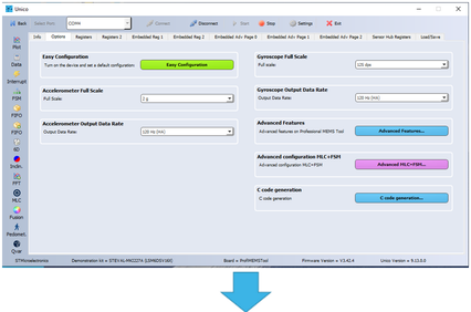

3. SFLP demo and tools

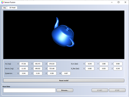

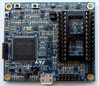

The hardware setup is STEVAL-MKI109V3 and DIL24 adapter board STEVAL-MKI227KA.
STEVAL-MKI109V3
The software used is Unico-GUI.

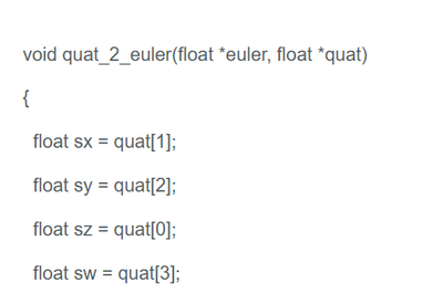

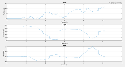

When you shake the demo board, the image follows the actual position displayed. SFLP has integrated quaternion, so customers can directly get quaternion and convert it into euler angles.

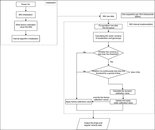

4. Yaw angle automatic calibration flow
Due to the long-term operation of the gyroscope, the integration error caused by zero deviation becomes increasingly large. The yaw angle may experience significant drift due to lack of calibration of the magnetometer. To solve this problem, the SFLP algorithm adopts a dynamic self-calibration method to ensure yaw angle stability.
5. Automatic calibration flow

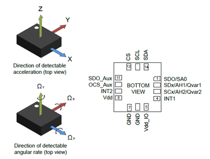

Coordinates:
Pitch rotation around the X-axisΩP
Roll rotation around the Y-axis ΩR
Heading/Yaw rotation around the Z-axisΩY

SFLP Register description:
Register bit config |
Bit description |
SFLP_GAME_EN |
Enables SFLP |
SFLP_GBIAS_FIFO_EN |
Enables Gbias in FIFO mode |
SFLP_GRAVITY_FIFO_EN |
Enables gravity vector in FIFO mode |
SFLP_GAME_FIFO_EN |
Enables game rotation vector in FIFO mode |
SFLP_GAME_ODR_[2:0] |
Configures SFLP ODR |

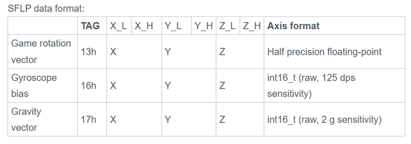

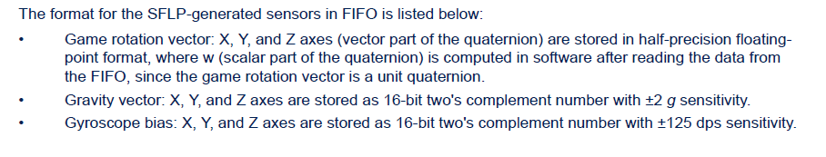

SFLP data format:
TAG |
X_L |
X_H |
Y_L |
Y_H |
Z_L |
Z_H |
Axis format |
Game rotation vector |
13h |
X |
Y |
Z |

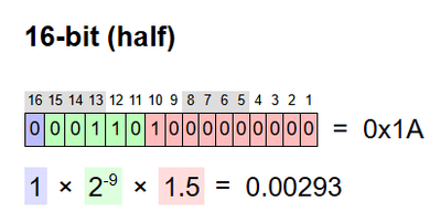

Half precision floating-point |
Gyroscope bias |
16h |
X |
Y |
Z |
int16_t (raw, 125 dps sensitivity) |
Gravity vector |
17h |
X |
Y |
Z |
int16_t (raw, 2 g sensitivity) |
