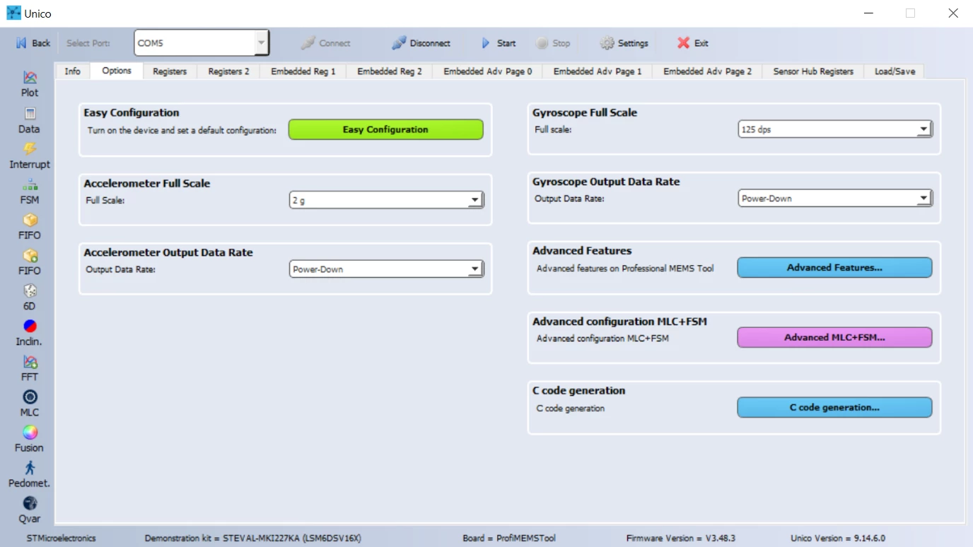

  • STSW-MKI109W referenced as Unico-GUI, companion software to work with the ProfiMEMS motherboard. Check that your Unico-GUI version is up to date (version 9.14.6.0 has been used for this example).
  • Unico-GUI is used to make a configuration file of the MLC and ASC for LSM6DSV16X.

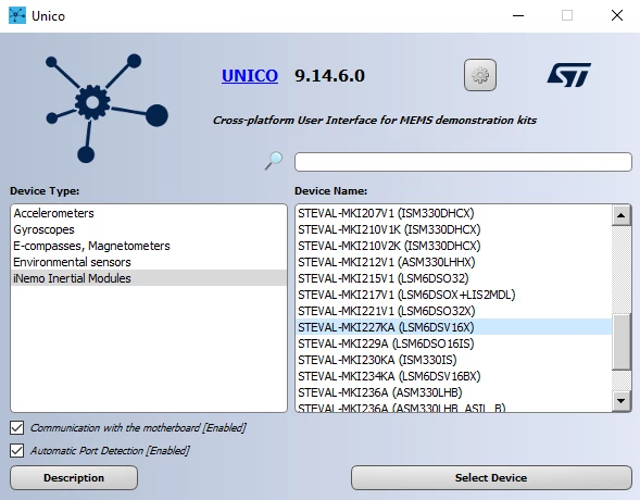

  1. Plug in the STEVAL-MKI227KA adapter to the ProfiMEMS motherboard and connect the motherboard to the PC using the micro-USB cable.
  2. Run Unico-GUI and select LSM6DSV16X from the iNEMO inertial modules list and confirm by pressing the select device button.

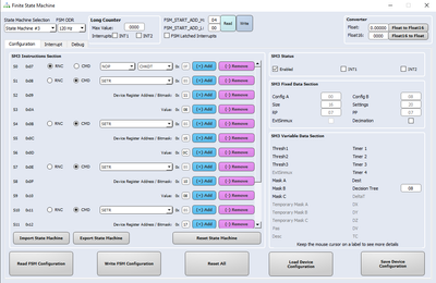

3. Configuring the FSM
We use three-state machines.
  • State machine 1 is used to configure the ASC when the MLC outputs the STILL state.
  • State machine 2 is used to configure the ASC when the MLC outputs the SHAKING state.
  • State machine 3 is used to configure the ASC when the MLC outputs the FASTMOVING state.

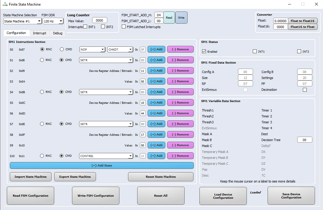

State machine 1 configuration:
  • S0 instruction is an RNC: NOP | CHKDT, configure the decision tree value to 0, used to check the MLC output value, if equal to 0, go to the next state.
  • S1 instruction is a CMD: SETR, used to enable the ASC feature.
  • S2 instruction is the device register address: 0x11, used to set the IMU CTRL2 register.
  • S3 instruction is Value:0x00, used to set the CTRL2 register value to 0x00, set the gyroscope to power-down.
  • S4 instruction is CMD: SETR, used to enable the ASC feature.
  • S5 instruction is the device register address: 0x10, used to set the IMU CTRL1 register.
  • S6 instruction is Value:0x44, used to set the CTRL1 register value to 0x44, set the accelerometer to low-power mode 1 and ODR to 30Hz.
  • S7 instruction is a CMD: SETR, used to enable the ASC feature.
  • S8 instruction is the device register address: 0x17, used to set the IMU CTRL8 register.
  • S9 instruction is Value:0x00, used to set the CTRL8 register value to 0x00, set the accelerometer FS to 2g.
  • S10 instruction is a CMD: CONTREL, used to reset the program.

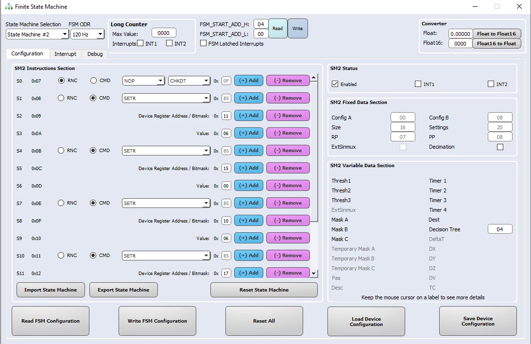

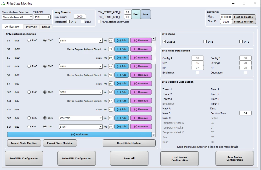

State machine 2 configuration:
  • S0 instruction is an RNC: NOP | CHKDT, configure the decision tree value 4, used to check the MLC output value, if equal to 4, go to the next state.
  • S3 instruction is Value:0x06, used to set the CTRL2 register value to 0x06, set the gyroscope to high-performance mode and ODR to 120Hz.
  • S5 instruction is the device register address: 0x15, used to set the IMU CTRL6 register.
  • S6 instruction is Value:0x00, used to set the CTRL6 register value to 0x00, set the gyroscope FS to 125dps.
  • S7 instruction is CMD: SETR, used to enable the ASC feature.
  • S8 instruction is the device register address: 0x10, used to set the IMU CTRL1 register.
  • S9 instruction is Value:0x06, used to set the CTRL1 register value to 0x06, set the accelerometer to high-performance mode and ODR to 120Hz.
  • S10 instruction is CMD: SETR, used to enable the ASC feature.
  • S11 instruction is the device register address: 0x17, used to set the IMU CTRL8 register.
  • S12 instruction is Value:0x01, used to set the CTRL8 register value to 0x01, set the accelerometer FS to 4g.
  • S13 instruction is a CMD: CONTREL, used to reset the program.
  • S14 instruction is a CMD: STOP, the end of the program.

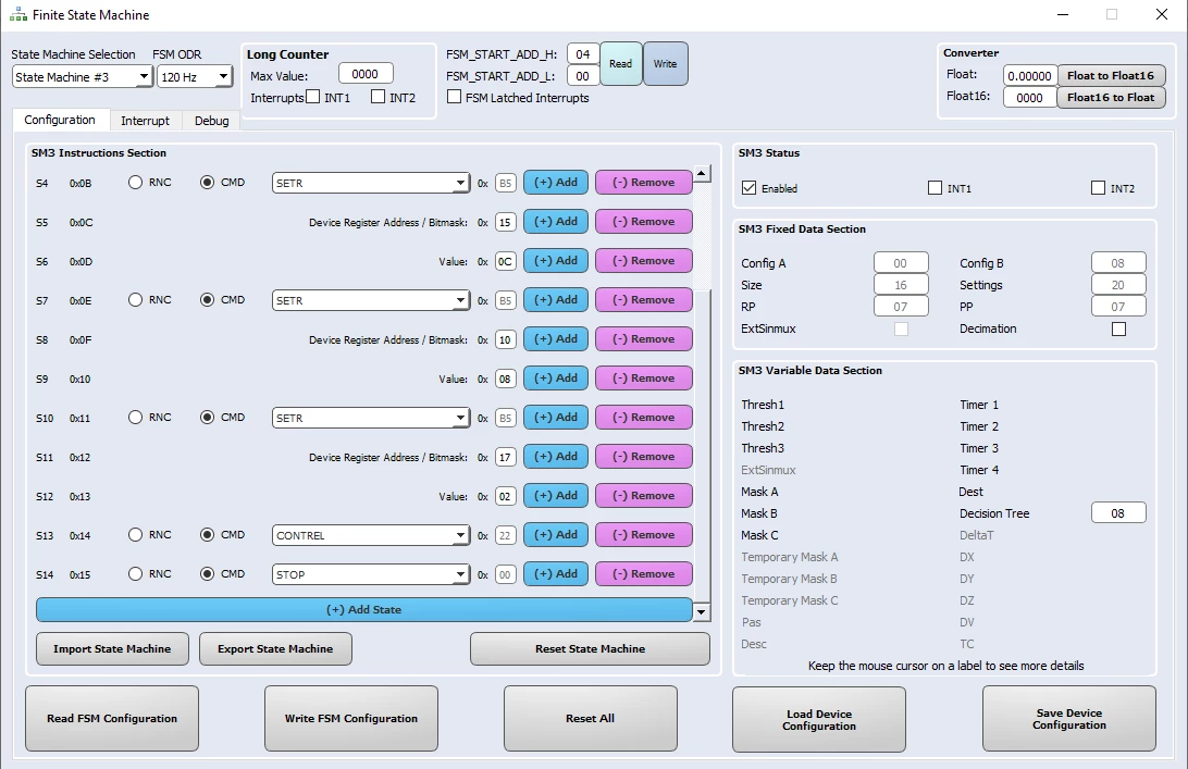

State machine 3 configuration:
  • S0 instruction is an RNC: NOP | CHKDT, configure the decision tree value 8, used to check the MLC output value, if equal to 8, go to the next state.
  • S3 instruction is Value:0x06, used to set the CTRL2 register value to 0x08, set the gyroscope to high-performance mode and ODR to 480Hz.
  • S4 instruction is a CMD: SETR, used to enable the ASC feature.
  • S6 instruction is Value:0x0C, used to set the CTRL6 register value to 0x0C, set the gyroscope FS to 4000dps.
  • S9 instruction is Value:0x08, used to set the CTRL1 register value to 0x08, set the accelerometer to high-performance mode and ODR to 480Hz.
  • S10 instruction is a CMD: SETR, used to enable the ASC feature.
  • S12 instruction is Value:0x02, used to set three CTRL8 register value to 0x02, set the accelerometer FS to 8g.

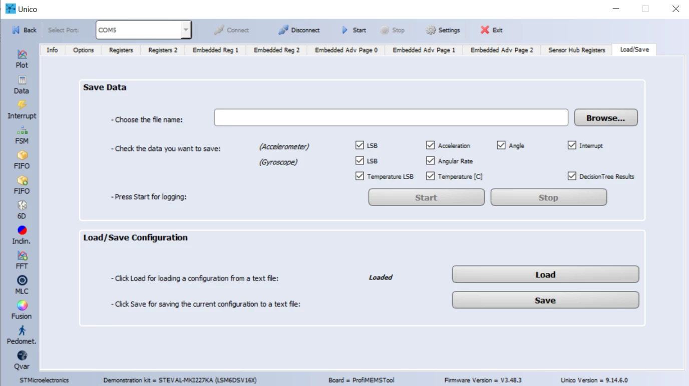

In the end, we successfully configured three state machines. Click on the save device configuration button. Save it to the PC (for example save it as the filename fsm.ucf).

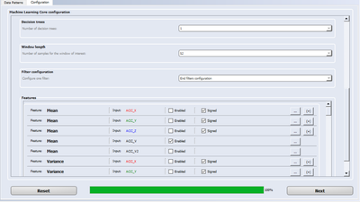

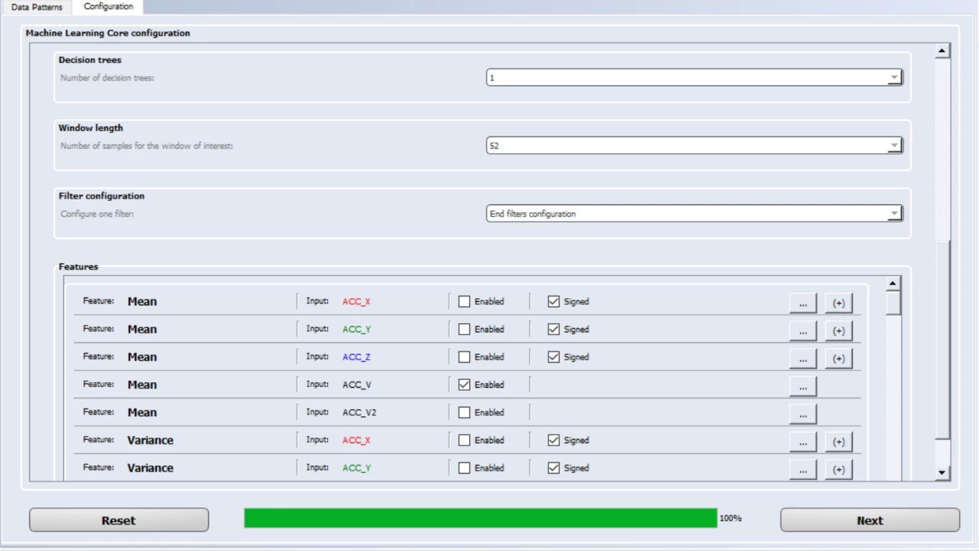

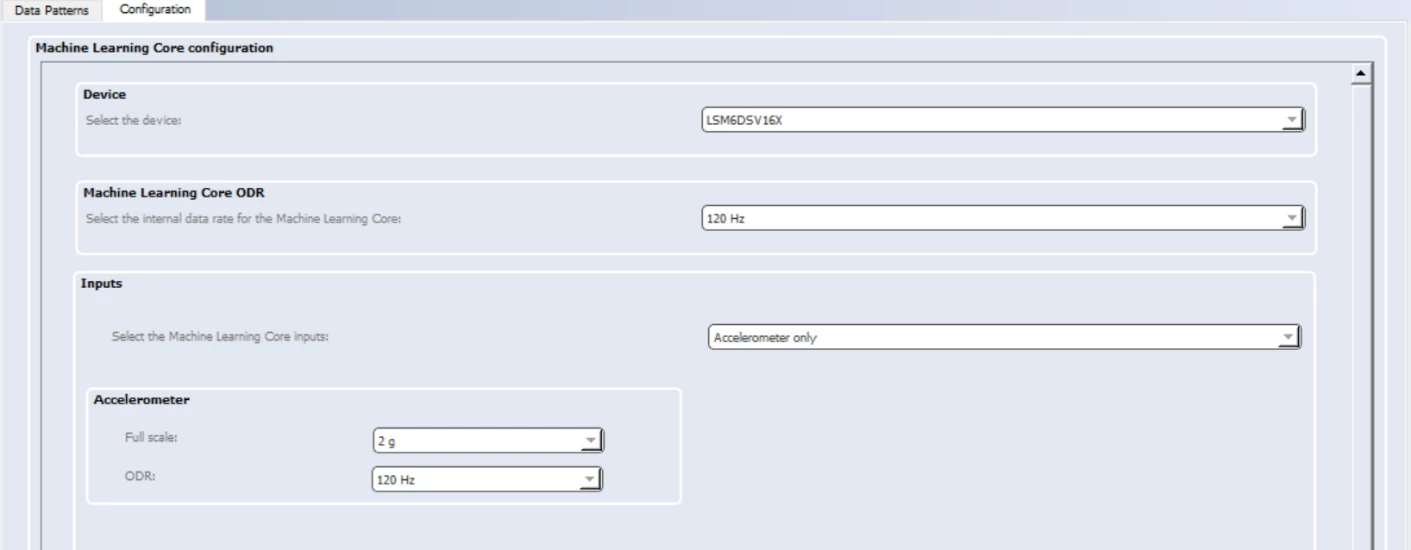

4. Configuring the MLC
Configuration parameters of the MLC
  •          MLC ODR: 120Hz
  •          Window length: 52 samples
  •          Filters: No
  •          Selected features:
  •          MEAN_on V and V2
  •          Meta classifier: No
Finally, the user is prompted to select the target UCF files and, by clicking next, it is automatically generated by Unico-GUI. Save it to the PC (for example, use the filename mlc.ucf).

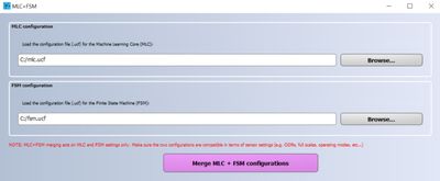

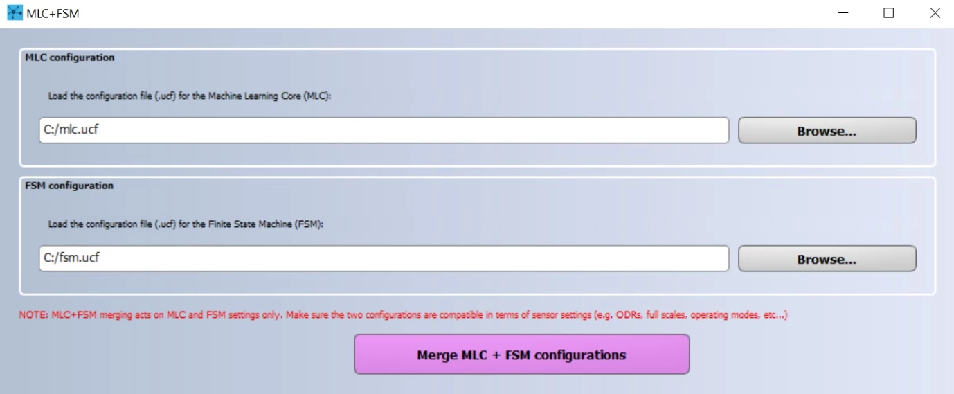

5. Merge MLC and FSM configurations
  • Select the advanced MLC+FSM button.
  • Load the MLC ucf file (for example, mlc.ucf)
  • Load the FSM ucf file (for example, fsm.ucf)
  • Click on the merge MLC + FSM configurations button and save it to the PC (for example, asc.ucf)
  • Select the load button to load the asc.ucf files to the evaluation board.

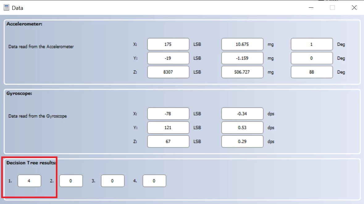

6. Demonstration on the evaluation board

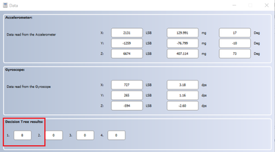

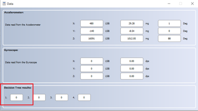

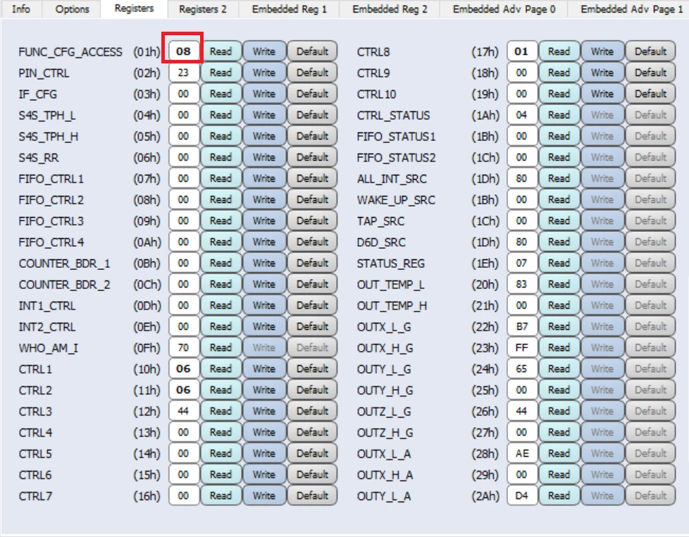

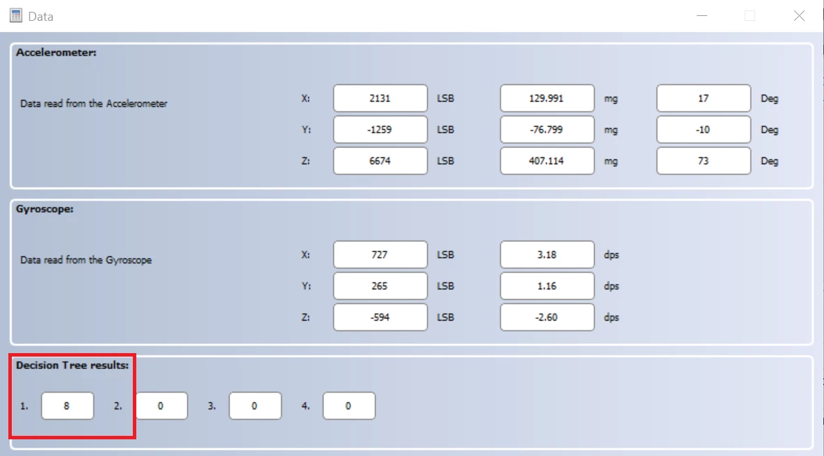

  • Enables the FSM to access the CTRL registers. Configure FUNC_CFG_ACCESS (01h) to 0x08.

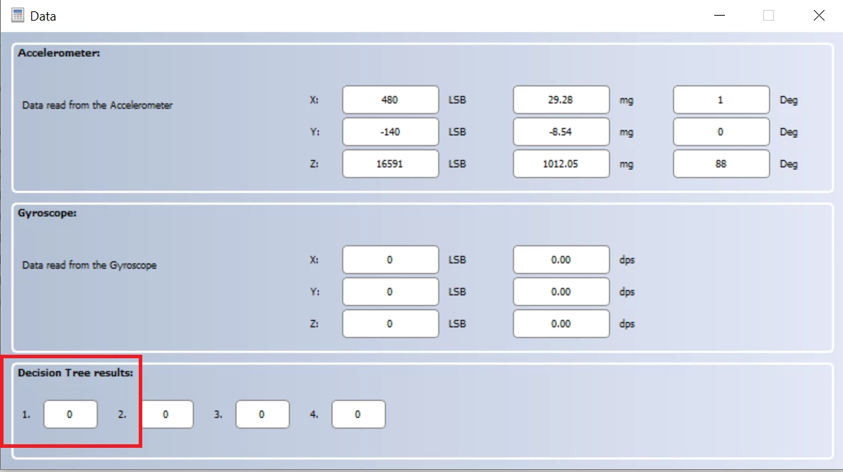

  • Data when the board is in STILL status, MLC output 0 and the ASC configures the IMU at XL ODR=30Hz,FS_XL=2g,gyroscope off, low-power mode:
  • Data when the board is in SHAKING status, MLC output 4, and the ASC configures the IMU at XL ODR=120Hz,FS_XL=4g, gyroscope ODR=120Hz,FS_Gyro=125dps, high-performance mode:
  • Data when the board is in FASTMOVING status, MLC output 8, and the ASC configures the IMU at XL ODR=480Hz,FS_XL=8g,Gyro ODR=480Hz,FS_Gyro=4000dps, high-performance Mode.

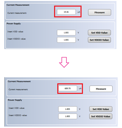

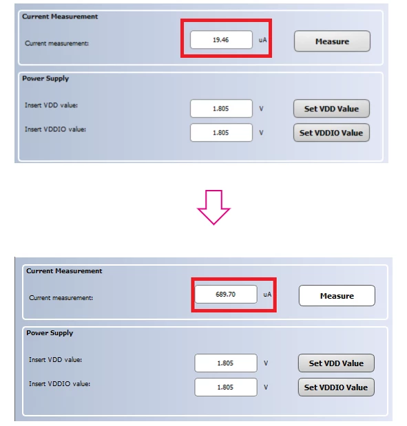

The result shows that when the device is in a STILL state, the current is 19.46 µA.
When the device is in a FASTMOVING state, the current is 689.70 µA.

Explorer
June 13, 2025
I believe the MLC in this case was trained with a specific ODR and Full scale.
How does it keep working through different ODRs and Full scales mentioned in the article?
Thank you very much! @Denise SANFILIPPO
June 16, 2025
Hi @sunshine25,
Yes, the MLC in this case was trained with a specific ODR and full scale.
If you change these parameters and use the MLC, as described in this article, to detect the three states of the sensor (still, shaking, fast moving), the trained MLC may exhibit unpredictable behavior. Therefore, retraining is required.
Explorer
June 16, 2025
Thank you, @Denise SANFILIPPO ! Do you mean different trainings need to be loaded into MLC every time ASC changes ODR and full scale?
June 17, 2025
Hi @sunshine25,
I mean that the MLC was trained considering the configuration setting described inside the paragraph 4, where you can see that MLC ODR is equal to 120 Hz.
I suggest you refer to the application note AN5804: LSM6DSV16X: machine learning core for further details.
