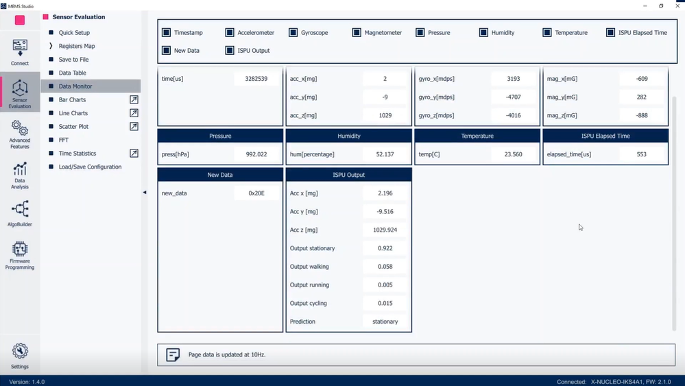

Figure 22: MEMS-Studio: Data Monitoring of ISPU output

Figure 22: MEMS Studio: Data Monitoring of ISPU output
