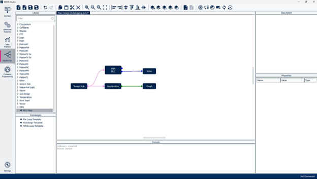

Figure 23:  The MCU stop block appears inside the MCU library

Figure 20: Create a “Custom library” called “MCU”, and inside it a custom block called “MCU Stop”
Figure 21: Set the required info, inputs, outputs, and the code to enable MCU stop block
Figure 22: Simple C code can be put in the function block, to enable stop mode
Figure 24: The block tree is completed
Figure 25: AlgoBuilder Evaluation - Custom layout
