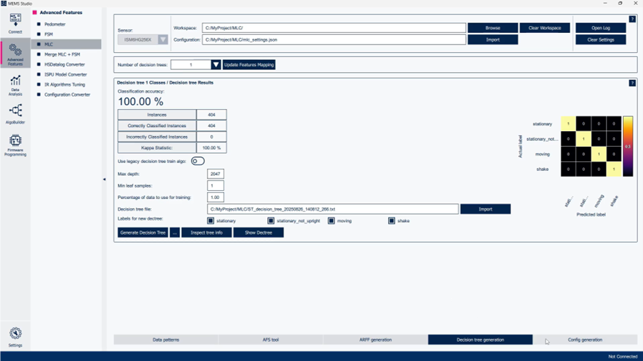

Figure 11: MEMS Studio - Advanced Features - MLC - Decision tree generation
