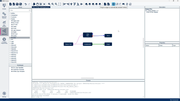

Figure 6: MEMS Studio - AlgoBuilder - Blocks

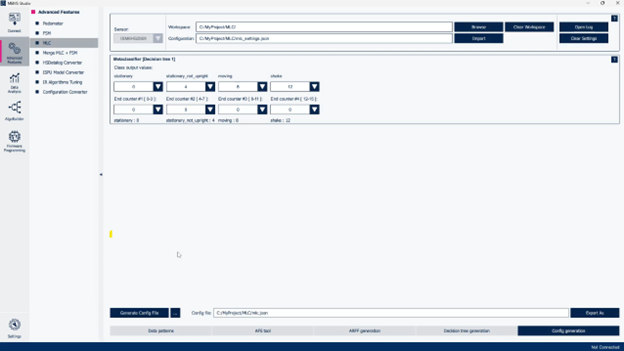

Figure 11: MEMS Studio - Advanced Features - MLC - Decision tree generation

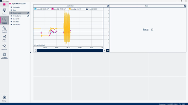

Figure 16: MEMS Studio - AlgoBuilder Evaluation - The package is still

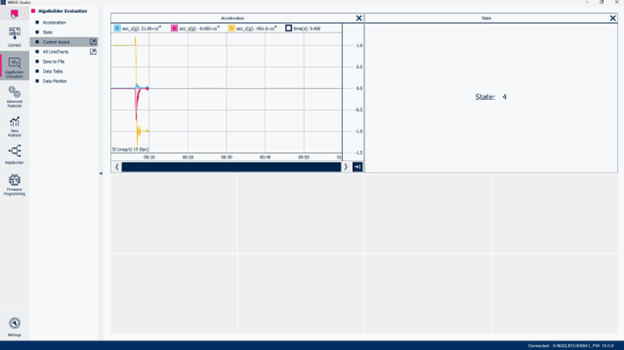

Figure 18: MEMS Studio - AlgoBuilder Evaluation - The package is moving

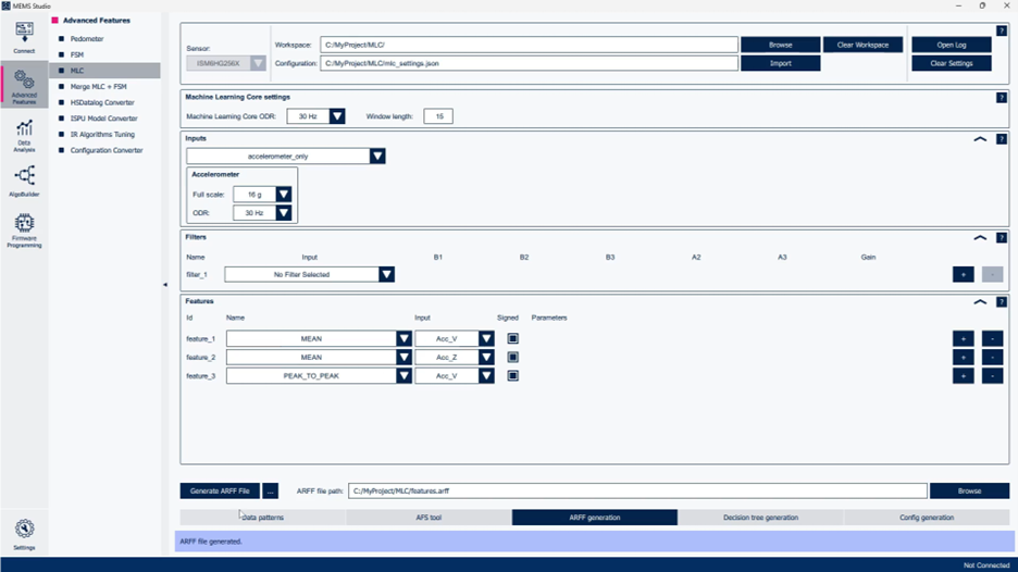

Figure 10: MEMS Studio - Advanced Features - MLC - ARFF generation

Figure 12: MEMS Studio - Advanced features - MLC - Config generation

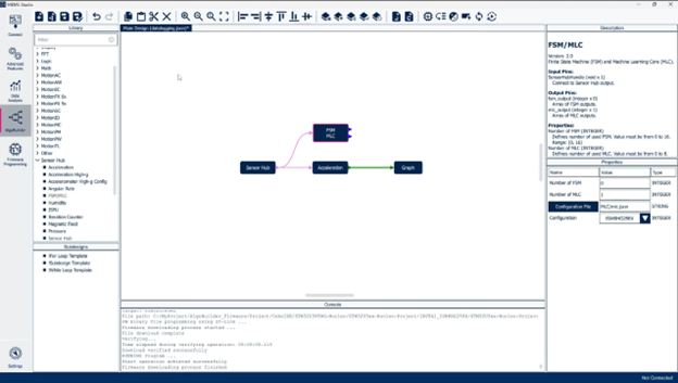

Figure 14: AlgoBuilder - Adding FSM/MLC blocks
