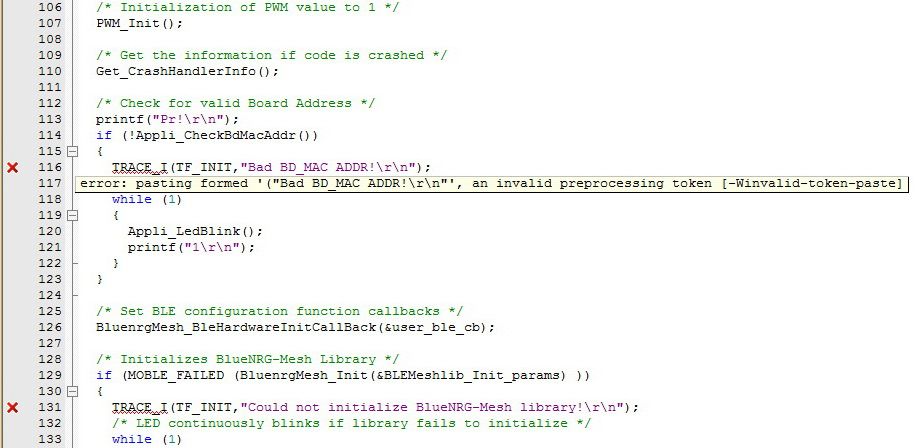

apronin47
Hi Winfred and alok!
Unfortunately, I'v got some problems with the module.
I suppose that the reason for the error pointed to by Keil. May be with this trouble debugger stops in "UART_Handler(void) {}"0690X000008w94sQAA.jpg
Is there some solution with your opinion?
Best regards,
Andrey
It shall be fine.
The Keil error says that the string "Bad BD_MAC_ADDR!\r\n" is not a valid token for the "##" preprocessor, which shall not matter here.
But in case it is really concerned, i think it might be OK to modify the marcros in mesh_cfg_usr.h (line 63):
#define TraceC0(...)
#define TraceC1(...) do { printf( __VA_ARGS__);} while(0)
#define TraceCX(flags, ...) TraceC##flags( __VA_ARGS__)
#define TRACE_I(flag, ...)   TraceCX(flag, __VA_ARGS__)

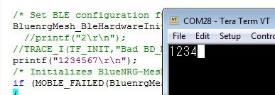

apronin47
Hi Winfred!
You were right. Although the changes made led to the elimination of the preprocessor error, the problem remained. It consists in the fact that the "printf" function displays only four characters. After that, the program hangs in this function and no longer goes. TRACE_I behaves similarly.
Unfortunately, I can’t find a place where the “printf�? output is redirected to UART. Since uKeil does not find a place to redefine the flow from the stdout to the Uart.
Best regards,
Andrey

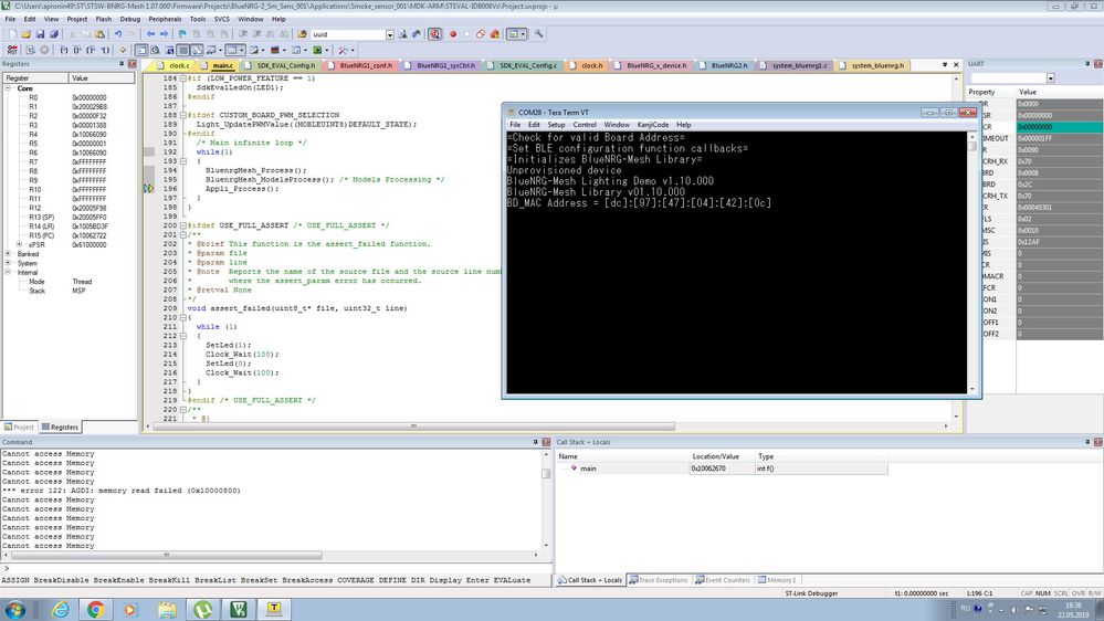

apronin47
Hi, Winfred!
Thanks for the answer. I received the correct response from the PCB using the debugger.
However, there are some features.
The fact is that I managed to get the correct response only in the uKeil debugger mode. I do it like this.
I launch the debugger for execution before the second printf command. Then I press the stop button in the debugger.
Then I put the cursor on the position of the working cycle
/* Main infinite loop */ and again start debugging.
And only after this, I get the correct response from the PCB which can be seen in the picture.
If I just reset the PCB, the board does not work and does not output anything to the UART.
Accordingly, I do not see the activity of the board in the application on the smartphone. Please help solve this problem.

Hi Andrey,
Please try in Debug Session press 'F5' to run for a while, then break MCU.
Possibly it is in some exception handler. Then you'll be able to backtrace the stack and check how it occurred.
