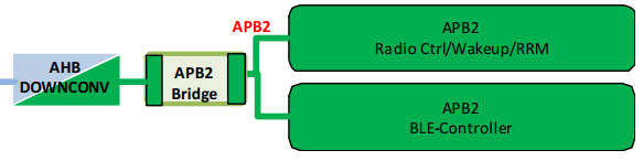

I couldn't find any specific documention but looking in RM0479 and directly in SDK sources here what I understood :
The RRM stands for Radio Ressource Management of the MR_BLE and DTBx is to change the Radio FSM directly through a test bus, if you have a look in function like RADIO_StopTone and RADIO_StartTone, there is byte like 0x39 which should correspond to a FSM state

Thanks. RADIO_StartTone and RADIO_StopTone fiddle with DTB5_DIG_ENG register, which is more documented in RM0480. The code snippet I posted plays with DTB0_DIG_ENG, which is not documented. I guess that's a way for the firmware to talk to MR_BLE.
Another thing that I find undocumented, is the alternate function 7 for PA1 that seems to be enabled in line 8.

4 I/O operating modes in RM0479
"The AF5 and AF7 configurations are ST internal only (for design, validation or engineering
teams) and should not be proposed to external customers"
