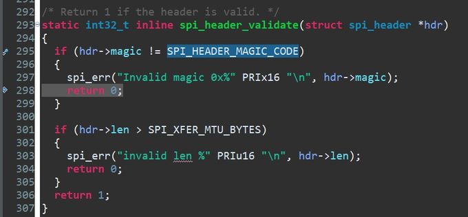

JohnWick1
I just found that the magic seem incorrect: it will run into line 297...any ideas? :(
And what i got is 0xAA54
But most of time, i got 0x00 magic number,  i just double checked the SPI/GPDMA setting in ioc, just follow this page:
Still no luck ...

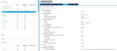

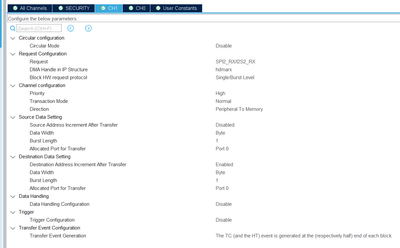

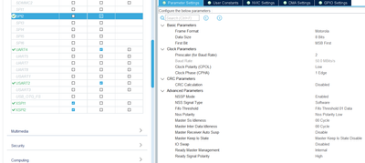

Dear Louis,
I had compared the SPI config in ioc, included DMA. it almost the same but just change to SPI2, not spi1.
I also found i had an error about DMA RX setting then correct it, but now, I got random magic number...
No idea what's wrong about SW.
SPI2 setting:
DMA setting:
