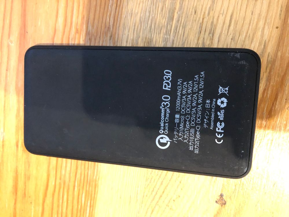

The above photo is the PD power bank I am using for testing. It support 9V/2A, 12V/1.5A. I tried to configure it to have 20V/1.5A, 12V/1.5A. The 12V/1.5A should be a valid PDO.

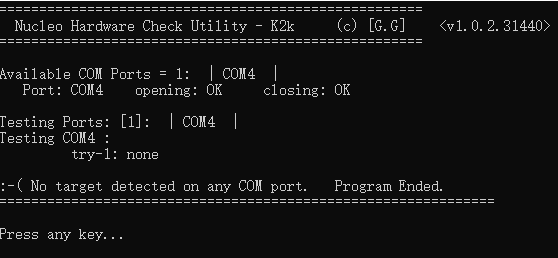

For the GUI, the GUI keep saying it can't find nucleo board. I am using a stm32f072RB nucleo with I2C connected to my STUSB4500 board designed by myself. I tried to follow the previous post about this issue but it does not fix the issue. Therefore, I can only program the chip by my own program.

Indeed the 12V profile should work with this power source.
But this power source cannot provide the 20V profile.

Before using the Nucleo board, make sure to flash it first with the latest firmware file: NUCLEO-F072RB_K2k_1.05.bin
If the GUI continue saying it can't find nucleo board, then try to use the diagnostic tool "HwCheckUtility.exe" (which is available in the zip file) to understand what is the issue coming from.
Regards
Hi, I used the new version of the GUI. It still cannot find the board. I used the HwCheckUtility.exe. The output log is capture in the above picture. Does it mean that there is a problem?
Leo Tai
Hi, I just realized that I just bought the wrong part number. The one I am using is "STUSB4500L". I just confused STUSB4500 with STUSB4500L. According to the datasheet, only STUSB4500 has PD feature while the STUSB4500L cannot is that true?
The output of HwCheckUtility.exe shows that it cannot detect the Nucleo-Board. So there is indeed an issue.
Even if the I2C chip is not connected, the utility should at least detect the Nucleo-Board.
So it means the firmware is not flashed properly into the STM32 Nucleo-Board.

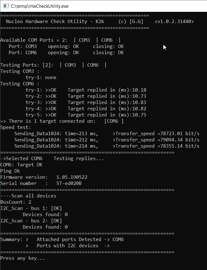

Here is an example of what you should get when the Nucleo board is detected:
