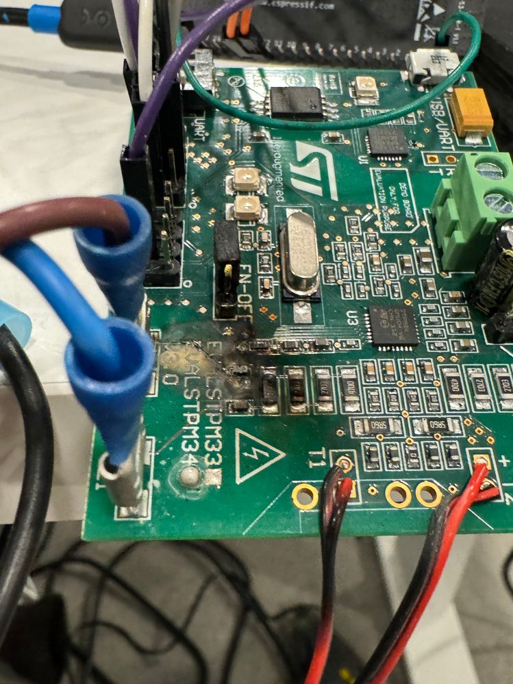

I am working with the STPM34/STPM33 chip and using the STPM34 evaluation board. I have noticed in my own hardware and the eval boards that when you attach power to measure voltage it shorts something and blows up.
Is this a known issue? Is there a known solution.
I attached a photo. Looks like a resistor that's blowing.

Hi Peter,
Thanks for your reply. I think I figured this out. It's when you reverse neutral and L1 it will blow.
‎2025-02-03 12:53 PM
Unfortunately, you have not shown how you have connected your setup. I can see the connection wires of the Rogowski coils, but otherwise a blue and a brown wire for mains. Blue is usually connected as neutral, brown as live. Is that the same for you?
How is L2 connected?
Regards
/Peter
‎2025-02-03 1:33 PM
Hi Peter,
