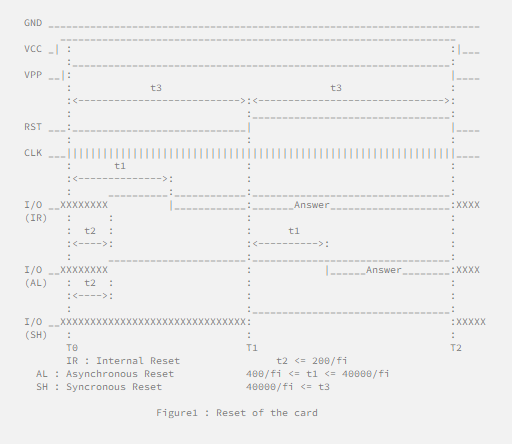

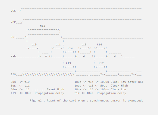

Please help i need to know about. Smart card interface ST8024CDR it can support Smart card ISO7816-3 in reset mode synchronous or not ? Now i using this ic it support only asynchonously
_legacyfs_online_stmicro_images_0693W00000dK32VQAS.pngasynchonously reset timming diagram
_legacyfs_online_stmicro_images_0693W00000dK32kQAC.pngsynchonously reset timming diagram
