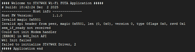

I'm giving it a try right now using a STM32H573I-DK and the X-NUCELO-67W61M1.
I cannot get the H573 to send data over the SPI port.
This is causing a failure for the start of the FOTA app.
I'm trying currently in station mode, before trying to switch to AP mode.
I did rework the ST67W board to use the on-board 32.768khz crystal which fixed one of the issues that was seen on the ST67W's UART interface.
The pins are matching for SPI using the Arduino header. I am using software pins for RDY and for NSS.
From my reading of the generated code, the SPI2 didn't seem to get initialized.
I did try initalizing it before the MX_ST67W6X_Init by using MX_SPI2_Init without success.
Any pointers to a solution?

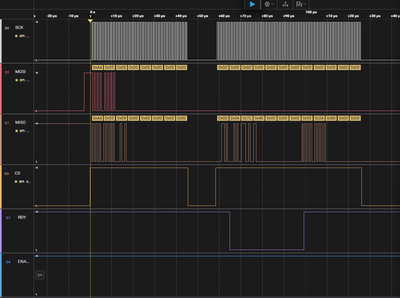

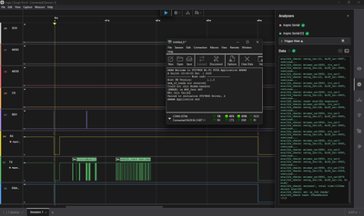

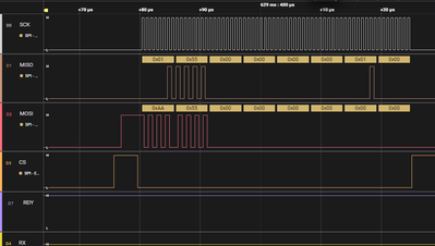

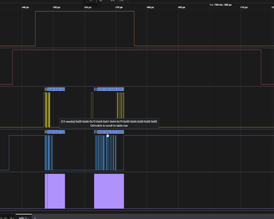

Got some progress,
I fixed the interrupts and intialization for SPI2. Now I get the module to communicate but the driver expects 0x55AA as the first magic code for the header, and I receive 0x5501 instead.
I did clock the SPI clock to 1.43 MHz due to instability at a higher clock.
The datasheet dosen't mention this magic constant, nor 0x55AA seems to be a "word" in the AT protocol.
Here is a logic analyzer capture of the data exchanged between the 2:
I also captured the UART traffic between the ST67W and the STM32H573.

'SYSMSG' (1) read failed
0xAA/0x01 0x55/0x55 0x00/0x00 0x00/0x00 0x00/0x00 0x00/0x00 0x00/0x01 0x00/0x00Part number:C6AFDBD111400004

#### Welcome to ST67W6X Wi-Fi FOTA Application #####
# build: 20:32:07 Dec 2 2025
--------------- Host info ---------------
Host FW Version: 1.1.0
spi rx transaction timeouted
Failed to receive the remaining bytes
spi txrx failed, -1
Failed to do the first transaction
waiting for spi txn ready timeouted
sem_if_ready not received
Could not init Modem handler
[ERROR] in W6X_Init API
W61 Init failed
failed to initialize ST67W6X Driver, 2
##### Application end
