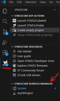

The STM32CubeIDE for Visual Studio Code solution consists of three main components:
  1. VS Code itself: Updates are controllable thanks to proper settings.
  2. VS Code extensions: It is important to understand what Visual Studio Code is. The platform is effective, as the end user has full control. However, STM32Cube cannot influence this aspect. The update model is fully customizable within Visual Studio Code. You can prevent automatic updates or manage updates for each extension individually, thanks to proper settings.
  3. STM32Cube bundles: These bundles include all collateral, such as the toolchain, programming, and debugging facilities. You can lock these bundles per project using the bundles manager.
You should be able to maintain full control.

Locking bundles is fairly safe and more meaningful to us, which is why we provide this bundle locking capability. The rationale is that bundles support core processing; we are fully aware that toolchain updates may impact end-user applications.
