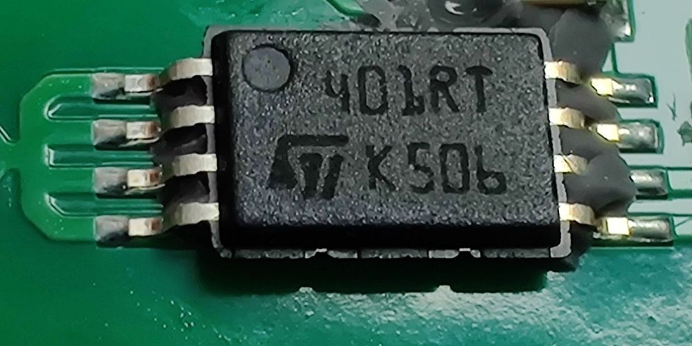

ST part from marking code
I am trying to find ST micro part from marking code given on it. It is 8 pin IC. Code is as below -
First line: 401RT
Second line: K50b

The second line is K506.
‎2019-12-24 12:48 AM
okay then what is this IC??
‎2020-01-01 11:19 PM
​Hello,
This is a 1Kbit EEPROM memory. Range 6 in TSSOP8 package.
M24C01-RDW6
Bye

Hello
I also have a similar TSSOP8 IC made by ST.
In the first line is written : 504RQ
and in the second line : K750
I appreciate if someone could help me what is this IC.
Thanks
‎2021-08-22 7:06 AM
Probably 25C04
2.5V to 5.5V for ST25x04 version
https://pdf1.alldatasheet.com/datasheet-pdf/view/23688/STMICROELECTRONICS/ST25C04.html
Second line is production location/data code
