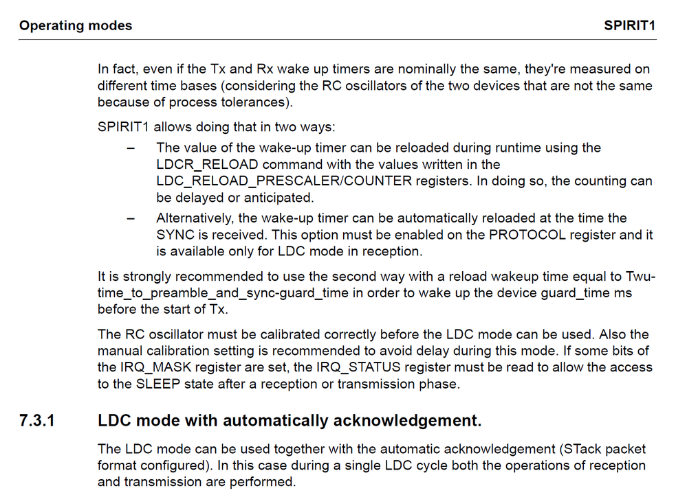

I have been reading on automatically reloading the wake-up timer at the time the SYNC is received, but I do not understand how to achieve this. I have tried configuring the LDC_RELOAD_PRESCALER and LDC_RELOAD_COUNTER values (registers 0x57, 0x58), and activating LDC_RELOAD_ON_SYNC in PROTOCOL[1] but it does not resolve the issue. Is there a method to wake up the device properly when the receiver is still in its SLEEP state? Any help would be greatly appreciated.
