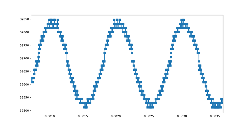

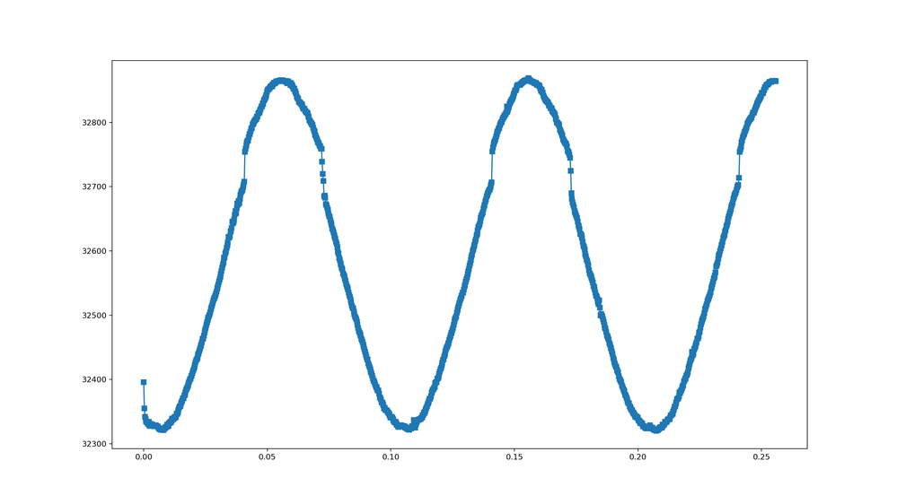

I'm seeing some very strange behavior on the ADC of the BlueNRG-LP. It looks like the ADC is skipping codes near the inversion point of a differential input, with similar behavior in single ended mode near 0.9V (with a 1.2V reference). This is on the STEVAL-IDB011V2 development kit.
High level description of the ADC configuration:
* Differential mode input on PB2/PB3 (differential input 0)
* 1MSPS sample rate
* 16 bit depth
* Downsampler active (ratio varies)
* Input common mode at 0.6V
* 1.2V internal reference voltage
* Analog watchdog off
* DMA active
What I'm seeing is that the ADC skips over a range close to, but not exactly at, the midpoint of the sample range. In 16 bit mode the range is approx 32700-32750 (with 32768 being the midpoint). See attached images (X axis is seconds, Y axis ADC code).
This is with the downsampler active.
0693W00000Sw21iQAB.png And this is sampling at full 1MSPS, no downsampling. Data is left shifted but you can clearly see that 1 or 2 codes are being skipped. This is a 1kHz sine wave input.0693W00000Sw2hUQAR.pngI see the same behavior in single-ended mode around 0.9V input, which is even further from the midpoint (which is 0.6V with a 1.2V reference). I've seen the same behavior on another analog input as well (PA14/PA15 as differential input).
