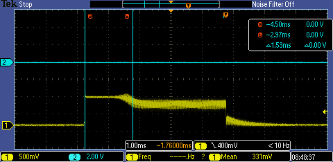

At chapter 4 (HS_Startup_time) I use the example firmware to compute this value but my results are very high according to the eval board.

Oscilloscope results:
0693W00000QKYDrQAP.pngTheses two results are consistent and give me a HS_STARTUP_TIME of 1500*1.1*1.3=2145µs.

I found the solution, I change this line according to my quartz:
system_BLUENRG_LP.c
LL_RCC_HSE_SetCurrentControl(LL_RCC_HSE_CURRENTMAX_5);
