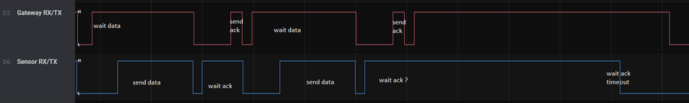

I use two X-NUCLEO-S2868A2 board with blueNRG-2 with BlueNRG-1_2 DK 3.2.1 and S2-LP_DK_1.3.2
I use following RF configuration :
#define MODULATION_SELECT           MOD_2GFSK_BT1
#define DATARATE                    50000
#define FREQ_DEVIATION              25000
#define BANDWIDTH                   100000
#define POWER_DBM                   14
    SRssiInit xSRssiInit = {
        .cRssiFlt = 14,
        .xRssiMode = RSSI_STATIC_MODE,
        .cRssiThreshdBm = RSSI_THR,
    S2LPRadioRssiInit(&xSRssiInit);
    S2LPRadioCsBlanking(S_ENABLE);
  1. RSSI_THR is -100 when I wait for a packet. I configured a s2lp gpio to change with Rx and Tx state : S2LP_GPIO_DIG_OUT_TX_RX_MODE = 0x90 in S2LP_Gpio.h. My issue is that i lose some packets. As you can see in the following screenshot, the sensor enter Rx state before gateway sends its ack. I use the antenna provided with the eval board, and the two boards are very close, few cm. Is it common to lost few packets considering this range ? or am i missing some parameters or functionnalities provided by s2lp ?

With datarate 20k, freq deviation 40k, BW 102k, rssi filter gain = 14, carrier sense mode : RSSI_STATIC_MODE. the preamble pair was set to 0011 by default, so i changed it to 01. I achieved 163m in free field with 100% received packet and -90 RSSI. It should be enough for my project. I had same results with two cc1310. In AN5528, Figure 15. RSSI vs. distance (868 MHz), they have -90 dBm after 500m, is the sand good ?

For 1. Replace RSSI_STATIC_MODE by RSSI_DYNAMIC_18DB_STEP_MODE seems to help but still packet loss.
Section 5.5.8.2 from https://www.st.com/resource/en/datasheet/s2-lp.pdf
"the carrier sense signal is asserted if the signal is above the threshold and a fast power increase of 6, 12 or 18 dB is detected". Is AGC could help ?
AndyR1
Senior
No packet loss using these settings
#define DATARATE                    20000
#define FREQ_DEVIATION              40000
#define BANDWIDTH                   102000
but Im stuck to 100 meters approx :( , increase frequency deviation should increase range : https://www.silabs.com/community/wireless/proprietary/knowledge-base.entry.html/2015/06/09/data_rate_deviation-Cfz7 is it common to have only 100m with 20kbps ?
