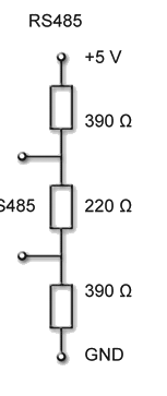

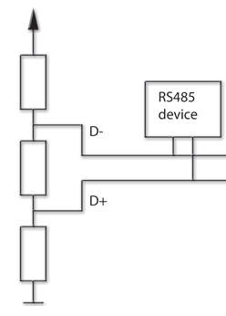

You should terminate with "standard" values, 3 r from gnd to vcc,
and just short the 2 x 220r in inputs (= 0 ohm) .
And D+ goes to the more negative biased line - you sure have not mixed up ?

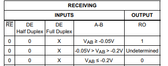

+ the difference between the transceivers here is there switching level;
STM +200mV/- 200mV (standard), renesas -50mV/-200mV  ---this might be the reason for different behavior.
