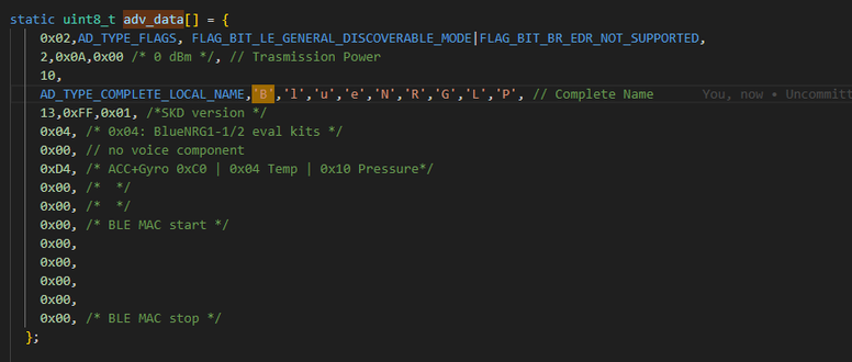

Hi community,
in the example code BLE_SensorDemo_BlueMSapp there are two places where the device name is set,
this one looks reasonable for the device name, but I tried to change it, actually this does not affect the device name, which is shown in the mobile, at all.
and the other one, this does really affect the device name in the mobile phone.
I want to make the code clean and use only one global variable to set the device name, how shall I reorganise the code?

I'm also working with this project on Bluenrg-m2sa and I'm very disappointed about the quality of this code samples and documentation. This is not the quality I'm used to get from ST!
