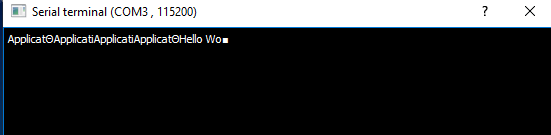

I have a custom board based on STEVAL-IDB011V2 EVM. Is the same schematic but I have a problem with this. Apparently it boots but not run...
When I flash "Hello World" example I have some issue that I can't check why.... The expected message does not is sent complete. So I have this output:
In this test, I reset the board sometimes. Some times it shows "Applicat", "Applicati", (Probably bootloader output?) Some times it shows truncated "Hello World".
I checked voltage levels by https://www.st.com/resource/en/application_note/an5503-bringing-up-the-bluenrglp-bluenrglps-devices-stmicroelectronics.pdf application note (bringing up the bluenrglp devices).
I tried the Power Supply test (flashing DTM Firmware - UART without update) and VDDA thats we expect 1.2V, I measured 0V. The Core voltage (VCAP) I measured 1.2V as expected.
I also tried flash other firmware examples without success.
Can someone help me?

I guess the problem was related to 22nH used for SMPS instead of 10uH (22nH is optional and can helps in sensitivity performances - "killing" the SMPS spurious).
Please confirm.

Yes, was it that's what caused the issue. Sorry for inconvenience.
As suggestion, clarify it in EVM schematic.
