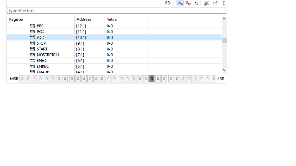

Read the reference manual. If PE=0, the peripheral is not enabled and will not do anything. The START and ACK bits are cleared to 0 by hardware when PE=0.

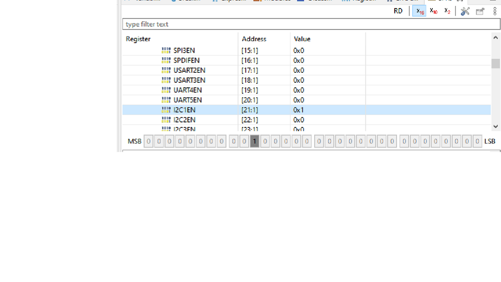

I2C1 is clock is enabled in RCC register
0693W00000BaCFnQAN.pngAfter setting the ACK in I2C1_CR1 it is not getting set
Did you set PE=1?
PK
@TDK​
No Actually I am trying to do I2C1 inits. So I am trying to set the ACK bit (Bit 10 ) in the I2C1_CR1 register so that the acknowledge will be enabled. I am not starting the communication yet. PE=1 when the communication will be started. Am I right?

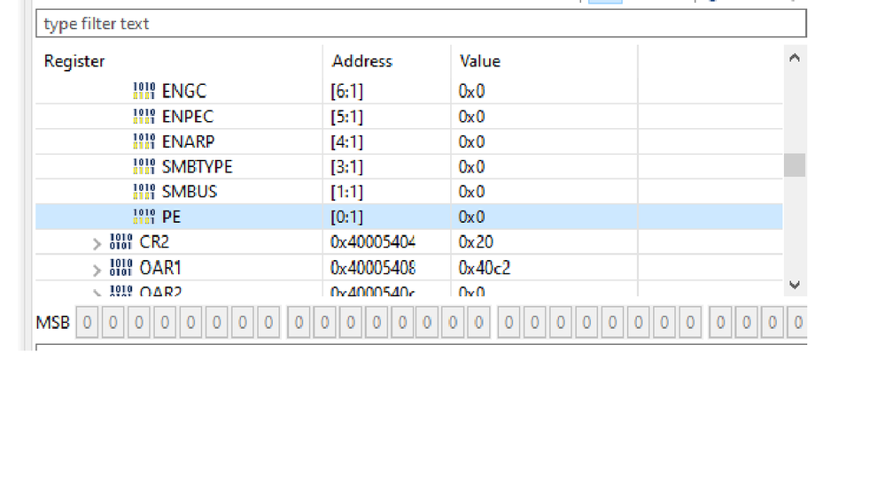

@TDK​ As you said I also tried to enable PE after I2C1 init but PE and START condition are not getting enabled.

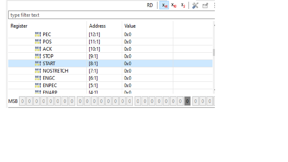

START:
0693W00000BaCb0QAF.pngPE:
0693W00000BaCbFQAV.pngAm I missing anything?
