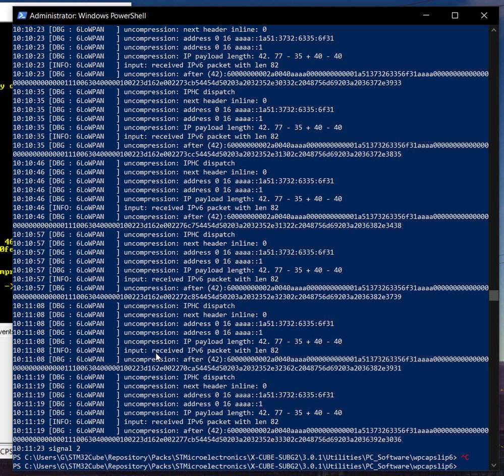

Hello, @MGREL​ ;
Thank you for your replay.
I try your advice. It's working. I would like to show a photo below

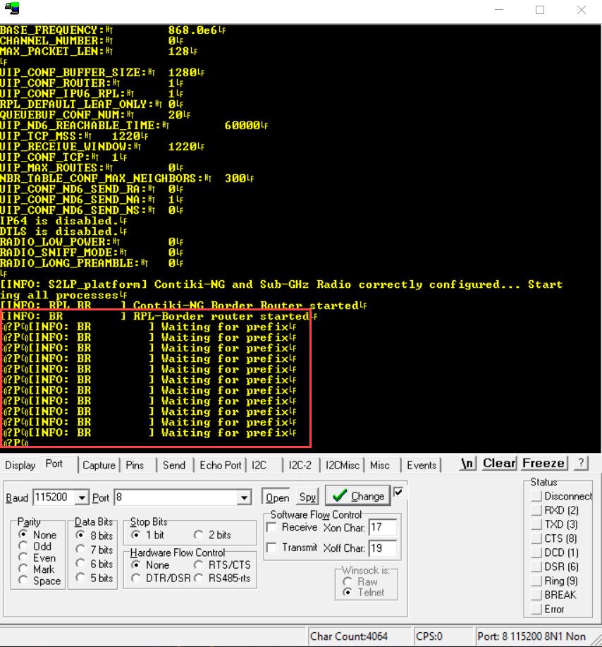

0693W000007ERalQAG.jpg I would like to turn off the message from Border Router is "Waiting for prefix" and I would like to show the message from client at serial terminal. Show a photo below
0693W000007ERaqQAG.jpg Could you please advice me the solution for this issue ?

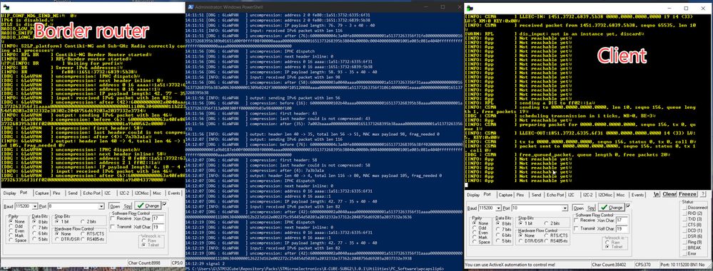

Gz
Senior
Hello, @MGREL​ ;
I would like to show a photo. The first time will not work when I open terminal for Border router and terminal for Client.
When I use PowerShell. It's working. I would like to know how I can setup all without PowerShell. Show a photo below
Could you please advice me this issue?
Thank you,
Best regards.
MGREL
Hello, I am not sure if I have understood the problem. The Border Router can work only if connected to tunslip6/wpcapslip6 because it needs
  • the parameters to form the network (network prefix and host address)
  • the user space tunnel application to connect to the host protocol stack
so if you use a terminal you just see Border router output that is basically SLIP6 packets (and debug messages if you enable them)
If you don't need to send UDP data to the host PC you can use the UDP Server firmware that implements also the RPL root.
