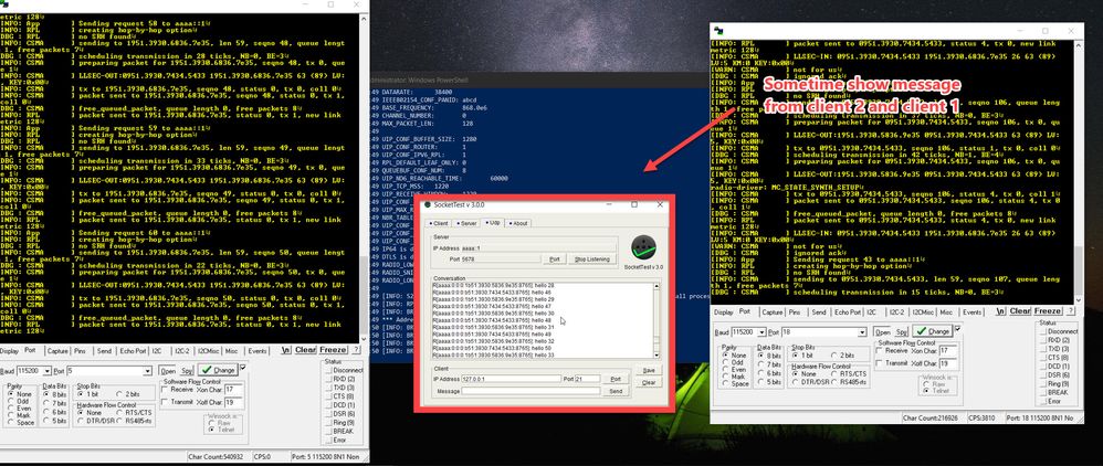

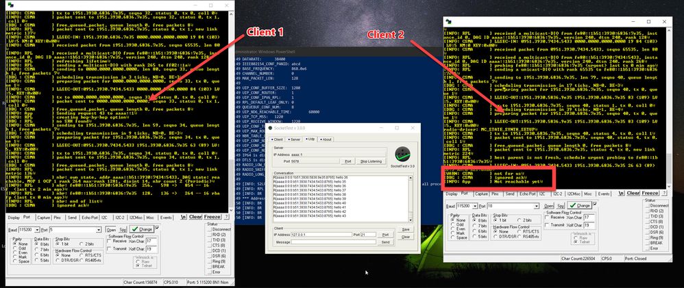

I am try this your solution. My network is not mesh tropology. show photo below
0693W000007CyFrQAK.jpgThis photo. Client 2 should send the data to Client 1 then Client1 send the data from Client 2 to Border router.
0693W000007CyG6QAK.jpgThis photo to show message client 1.
Could you please advice me to make mesh tropology with S2-LP ( Client mesh example )?

if you configured both the UDP Clients to send data to "aaaa::1" address it is normal that you see the UDP messages on the UDP Server running on the host, this regardless the fact that the network topology is star or mesh.
To try to setup a mesh (multi-hop) you can try to setup a linear topology with the second node in the radio range of only the first node:
BR ------- NODE1 -]------ NODE2
Where ']' is the end of BR's radio range.

I try your solution. It's successful. I have a question below.
  1. I would like to know why Client1 and Client2 use a long time ( Some time ) to connect to Border Router.
