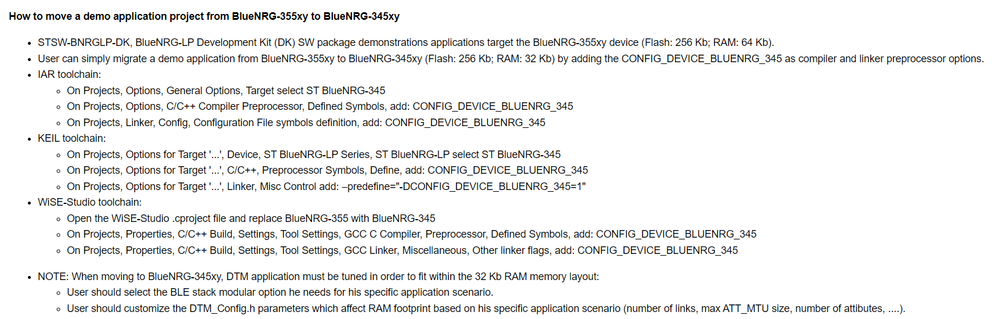

We are doing FCC and BQB approval next week and I am trying to build the DTM project for the BlueNRG-345 and have the requisite defines for C/C++ and linker but it runs out of RAM on the build.
Please explain and point me to the correct changes needed

To build DTM for BleuNRg-345, you need reduce RAM footrpint to fit into 32KB memory : see extact below from SDK doc (4) Design & Bringing Up custom BlueNRG-LP PCB)
0693W00000KbED8QAN.pngThis can be achieved by changing preprocessing option of your DTM project.
For regional certification, you can reduce number of Advertising sets and number of maximum simultaneous connection.
NUM_ADV_SETS_CONF=1
CONFIG_NUM_MAX_LINKS=1
et me know if it solves your issue.
