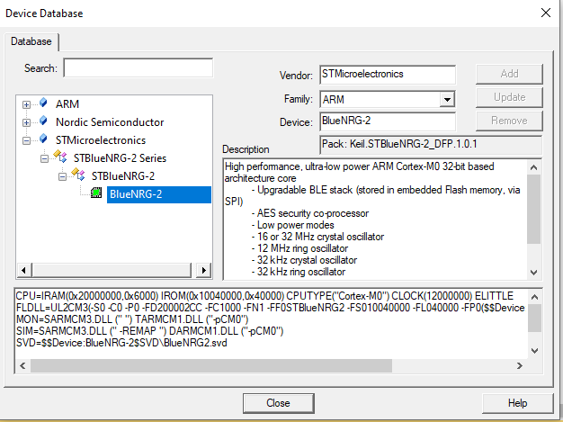

I have downloaded Keil uVision5 IDE and also BlueNRG SDK from:
https://www.st.com/en/embedded-software/stsw-bluenrg1-dk.html

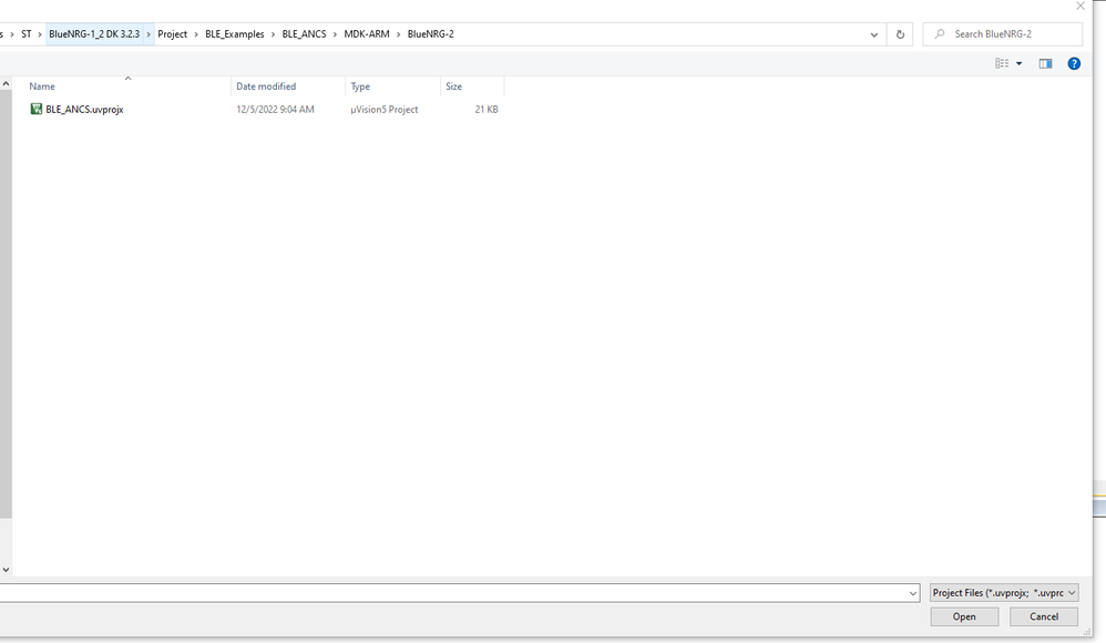

In Keil, I go to Project->Open Project,
Then in the BlueNRG SDK that I have downloaded I go:
ST->BlueNRG-1_2 DK 3.2.3->Project->BLE_Examples->BLE_ANCS->MDK-ARM->BlueNRG-2 and open BLE_ANCS.uvprojx

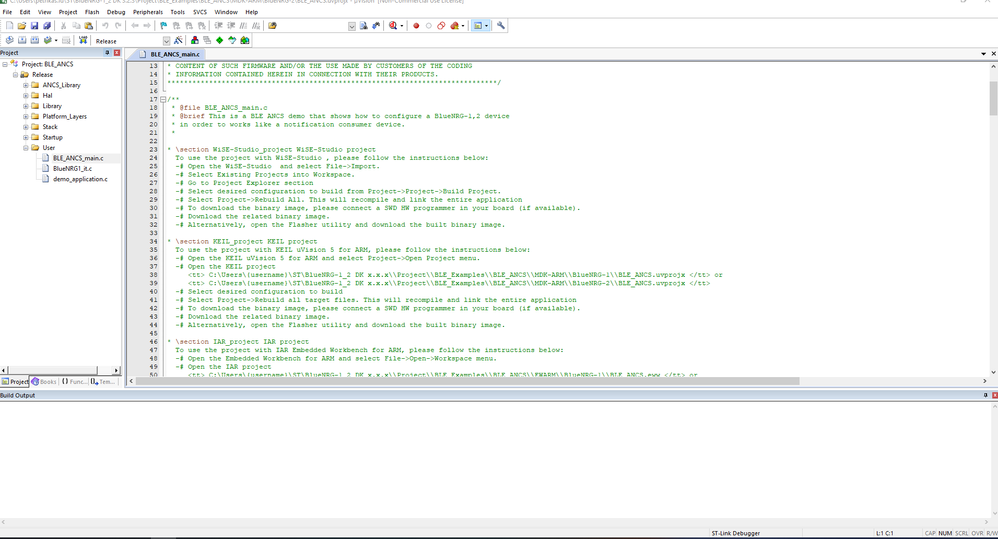

I open the project and I can see it:

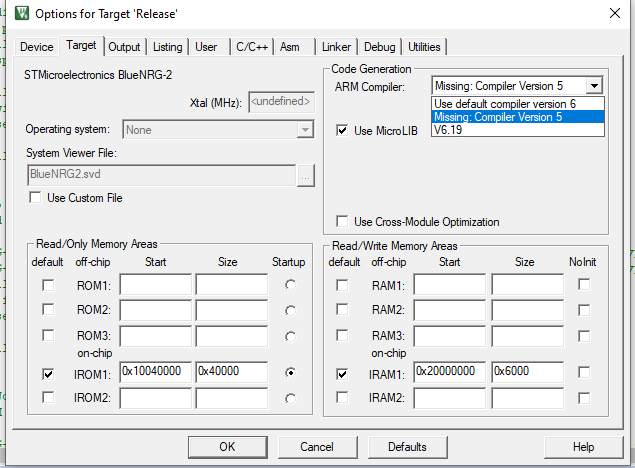

I simply try to build the project and get the following error:
Build started: Project: BLE_ANCS
*** Target 'Release' uses ARM-Compiler 'Default Compiler Version 5' which is not available.
*** Please review the installed ARM Compiler Versions:
  'Manage Project Items - Folders/Extensions' to manage ARM Compiler Versions.
  'Options for Target - Target' to select an ARM Compiler Version for the target.
*** Build aborted.
Build Time Elapsed: 00:00:00
In my target options, I see the folowing compilers available:
I have tried with default compiler 6 and I get a bunch of compilation errors:

I also tried with to select V6.19 but it is same as above.
Could someone point me in the right direction how to solve this issue? I have read a simillar post here:
https://community.arm.com/support-forums/f/keil-forum/52719/how-can-i-install-compiler-version-5-for-keil-vision-5
and I cannot fully understand why do we need a seperate compiler? Why default compiler that is being installed when you install Keil not good?
Is this the only option to install Arm Compiler 5.06 as it seems quite complex. You need to create account on ARM website and wait up to 5 days for their confirmation about your account...
