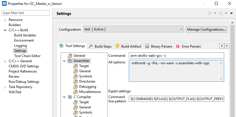

I'm new to TrueStudio and am having trouble updating the -mcpu=cortex-m0 option...
In all cases the ''All Options:'' field is grayed out and I'm unable to modify the contents (see attached screenshot). Any ideas on how to get around this?
Thanks!
jay

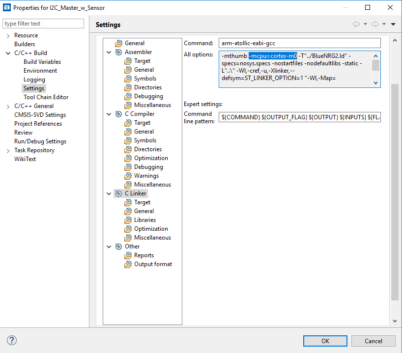

Posted on June 16, 2018 at 01:08
Thanks Piotr,
Just as a note to others still experiencing issues, I didn't have to modify the linker options, it was already configured correctly for me, this can be verified by looking at the 'All options:' field in the 'C Linker' submenu. Trying to add it a second time under the 'Other options' lead to build errors.
However, omitting this still didn't result in a working binary, it would compile fine but wouldn't execute properly. I additionally had to change the Assembler/C compiler/C linker->Target->'instruction set' from 'Thumb2' to 'Thumb'.
After these two changes I was able to compile, flash, and run the st examples.
jay

This is the same problem I was having. I found that -mcpu=cortex-m0 was already set in the
''All options:'' field in the ''C Linker'' submenu. If you add it a second time using the
''C Linker''->''Miscellaneous''->
''Other options:'' field, it leads to build errors.
Double check the ''All Options:'' field, see attached screenshot showing the -mcpu=cortex-m0 highlighted and already set. If it shows up here, you shouldn't need to add it using the Miscellaneous submenu.
jay
