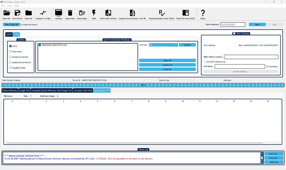

After flashing and running the example (BLE_OTA_ServiceManager), the module (BlueNRG-M2SA) can no longer be programmed via swd ((module still alive).
RF Flasher Utility 4.5
******MASS ERASE OPERATION******
14:35:14.540: Waiting device to Mass Erase memory (device connected by ST-Link) -> FAILED. (It's not possible to connect to the device)

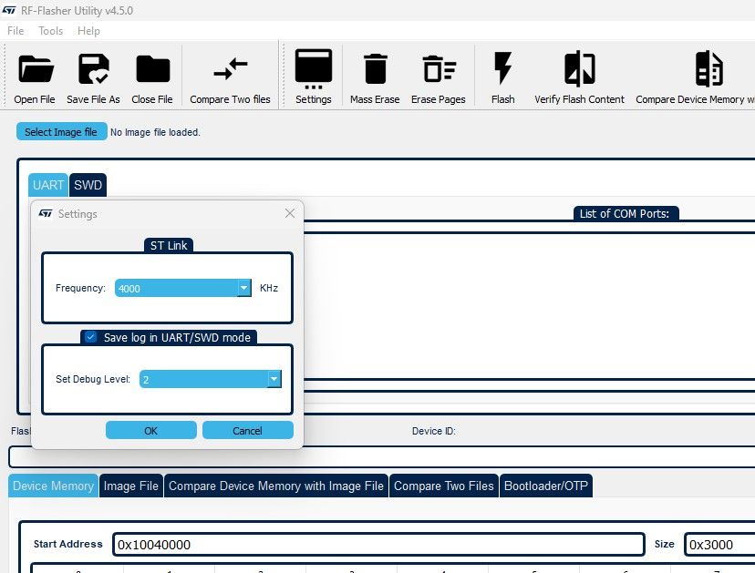

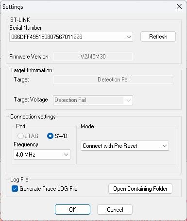

The solution to the problem was to use the 'BlueNRG-1 ST-LINK Utility' flasher. Settings as in the picture:
The RF-Flasher Utility application could not cope with the stuck module (No extended programming options):
