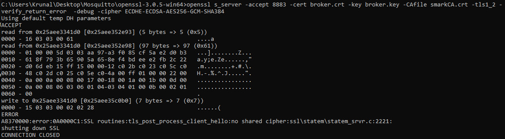

‎2023-02-19 11:27 PM
@Benjamin BARATTE​
Sorry for the delay in replying as I wanted to make sure I tried everything.
Also, Setting up local mosquitto server with SAN (Subject Alternative name) took time.
Finally I managed to setup local mosquitto server. I tested it using MQTT Explorer by providing client, server, CA certificates and it worked. This worked with/without client authentication using MQTT Explorer.
Later I tried running our code (first without client authentication), but it failed to connect.
Next, I tried using your provided command for openSSL, this time also without client authentication, but i am still getting that "no shred ciphers"
Here I have attached errors debug for device and openssl.
From this it seems I am still doing something wrong with the mbedtls configuration.
I have following enabled for medtls_config.h file:
MBEDTLS_ECP_DP_SECP256R1_ENABLED,
MBEDTLS_ECP_DP_SECP384R1_ENABLED
MBEDTLS_ECP_DP_BP256R1_ENABLED,
MBEDTLS_ECP_DP_BP384R1_ENABLED
MBEDTLS_KEY_EXCHANGE_ECDHE_ECDSA_ENABLED,
MBEDTLS_KEY_EXCHANGE_ECDH_ECDSA_ENABLED
MBEDTLS_ECDSA_C
MBEDTLS_ECDH_C
- disabled MBEDTLS_KEY_EXCHANGE_RSA_ENABLED
‎2023-02-27 8:49 AM
Hi @Community member​ ,
I see that the server use AES256 and SHA384 while the client does not propose such ciphersuite.
Did you activate the MBEDTLS_SHA384_C and MBEDTLS_SHA512_C ?
I see in the MbedTLS definition that the AES256 is only linked to the SHA384.
Therefore if you activate the SHA384 (and SHA512) you should provide more ciphersuite and be able to match server preferences.
Best Regards,
Benjamin
‎2023-03-04 4:02 AM
Hello @Benjamin BARATTE​ ,
Thanks for your support so far.
You were right, I had missed to enable MBEDTLS_SHA384_C.
Apart from this, my keys for broker and CA were generated using RSA which I later found that I need to generate ECP certificates and keys for broker and CA too.
I am working on it and have gone further.
Now I generated broker, CA, and client certificates using SECP384R1 and used cipher ECDHE-ECDSA-AES256-GCM-SHA384. So when I provided my generated client certificate, the handshake worked.
Next I incorporated your provided example and tried to use slot0 of stsafe. I noticed slot0 uses NIST-256 so I regenerated my broker, CA certificates using NIST-256 (prime256v1).
The handshake went much further and mbedtls_ecdh_gen_public() function was called from your provided file. However it fails when StSafeA_GenerateKeyPair() is called within this function. Following is the line that returns error "STSAFEA_INVALID_PARAMETER".
status_code = StSafeA_GenerateKeyPair(g_se_handle, STSAFEA_KEY_SLOT_EPHEMERAL, 0x0001U, 1U, 0, curve, size, &reppoint, &x, &y, STSAFEA_MAC_NONE);
On further debugging, I saw it fails at "IS_STSAFEA_HANDLER_VALID_PTR(pStSafeA)" within StSafeA_GenerateKeyPair(), however, I could see in debug it has a valid pointer.
Apart from these points, I am also facing problem with GenerateCSRFromPublicKey() function in your provided example file. Initially it was working, but now it returns error ret = -1. this is the code line that fails.
ret = GenerateCSRFromPublicKey(&stsafe_handle, COUNTRY_STR, ORG_STR, CN_KEY_1, KEY_1_CURVE, X, Y, display_buffer, &csr_size);
I feel now I am very close to getting STSAFE working with mbedTLS, thanks to your support. Waiting for your reply.
