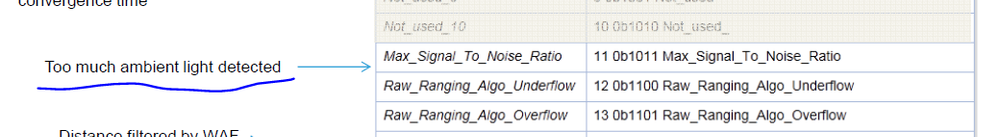

I am trying some settings on VL6180x for avoing "Max_Signal_To_Noise_Ratio" when ranginf under sunlight conditions.
I have tried to disable DMAX (#define DEF_DMAX_ENABLE     0), but still I get the MAX snr errror.
I have been trying to set other limit to SNR, Which I managed to do it, But no succes when ranging at sunlight.
I do not need high accuracy.
Regards, Ramon.

Hello Ramon,
You can try to reduce the noise by setting the readout__averaging_sample_period register
readout__averaging_sample_period: The internal readout averaging sample period can be
adjusted from 0 to 255. Increasing the sampling period decreases noise but also reduces the
effective max convergence time and increases power consumption:
You can find more details in the datasheet of the VL6180X here
Anne

Hello Anne,
Thanks for answering.
Note the error is given due to high ambient light.
0693W00000Npuf4QAB.pngDo you think by using longer sampling periods I can minimize the effect of the light?
Regards, Ramon.

Unless you really want to use the VL6180X, it is better to switch to the VL53L4CD outdoor. Please buy the evaluation kit and try it : P-NUCLEO-53L4A1.

I see you can range up to 130cm with this part. I just need to range up to 15 cm. I have a solid obstacle at 15 cm and I need to detect objects between sensor and obstacle.
Do you think this part is ok for ranging at 15 cm maximum?
Regards, Ramon.
Anne BIGOT
The VL53L4CD is a close distance sensor so it is OK for ranging at 15 cm.
